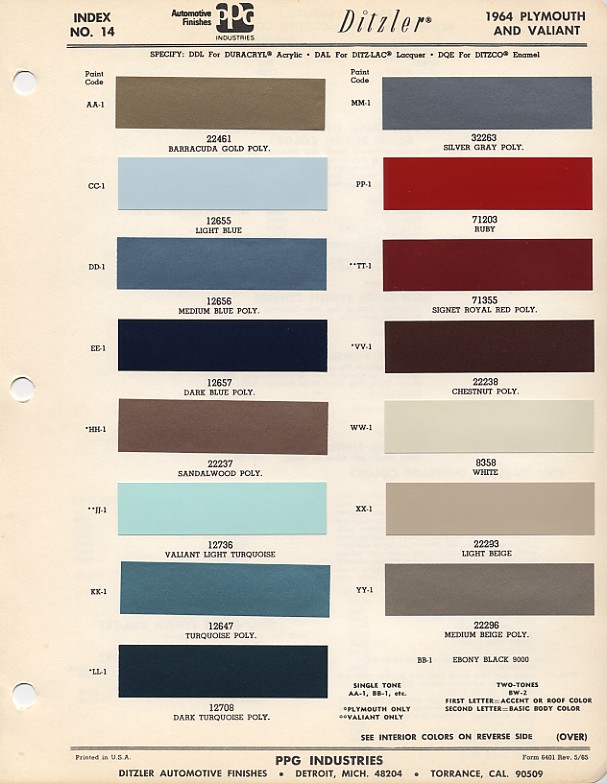

From what i have found online, the correct red for a 64 fury dash would be the color ruby, color code P. Is this correct?

I think what Zach is saying is that the PP-1 Ruby color that is listed for a 64 could be used for the body or dash or both if it were a ruby on ruby car.

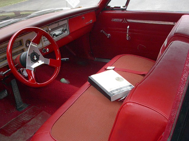

Ok.. i think i understand..My car will be black with red interior when complete. So if I paint my dash the ruby color , that should match the rest of the red upholstery that i will get from legendary auto in the future? Thanks for all the input .

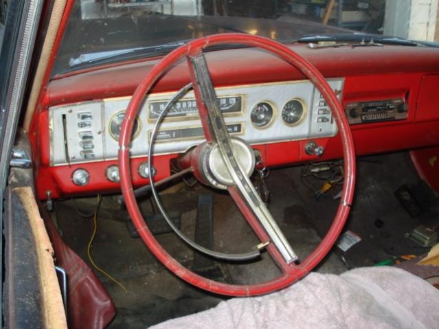

The dash was a two tone,The ruby red would be the lower part,from where the dash rolls down!The top would be a flaten red color,sort of a very fine wrinkle finish on the top.It was to reduce the glare of the sun.
on my 64 dodge it is a texture red top and a regular red bottom

Good to know! this is the first i have ever heard of a two tone on the dash but it does make sense. Do either of you guys know if that textured flat red on top is the same ruby red.. just dulled out? Or is it a special color & paint in itself? Appreciate all the good knowledge once again.
The paint is matte when the car did not come with a padded vinyl dash pad.

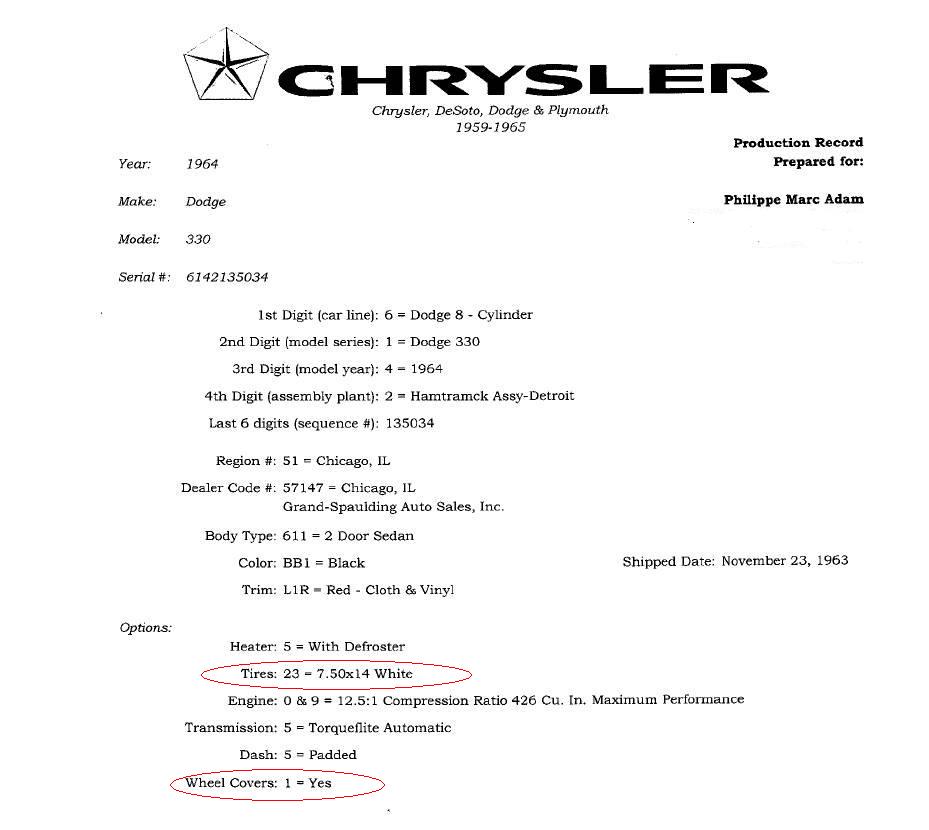

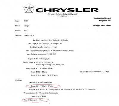

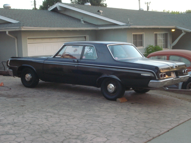

As far as padded dash on super stock models believe it or not they were a factory option as you can see on my Chrylser report, even padded dash cars had the top of the dash matted red.. excuse the crapy dash photo, that was the day my max wedge came home!

Thats a cool dodge you got there and neat that the paperwork is still with it! Is your car a rear seat delete also? i have heard that the rear seat delete cars used a special package tray as well since there wasn't a backseat, but i don't know that for sure.
Quite the color combinations they had back then. So basically black carpet , off-white headliner, and red everything else. Hard to believe that all those different colors in the same spot can look so cool!

mine has the rear seat,
rear seat delete didn't come until late 64 with the hemi cars..
