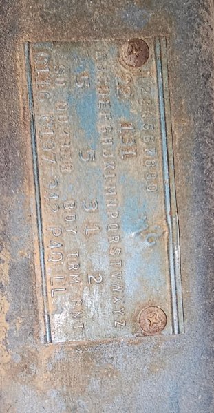

I need some help decoding the fender tag in attached photo. My uncle passed away and left me his 64 Plymouth Sport Fury. I've previously never had a problem finding this information on the internet? I bought a 67 Dart and found all the codes in 30 minutes.

'64s are a little harder to find the info online than '67. I'm away from my book at the moment. There's some on here that will help. We'll need the first four digits in your vin for a more accurate decipher..

Any chance we can get a little larger and more clear picture? The numbers in the lower left are hard to read.
The VIN would be something like 34411*****

Here is the tag numbers, sorry, I couldn't edit the photo any better.
The A-Z:
C=5
J=5
N=3
Q=1
V=2
Lower tag numbers:
SO=0116
NUMBER=0197
BDY=342
TRM=PHQ
PNT=LL
Hope this helps and sure appreciate it. My uncle lived in Missouri, where the Sport Fury is garage. He drove the car everywhere, but I don't know when I will be able to drive the 4 hours home.

Hi Craig. Here is my best stab at your build plate; going from bottom row of numbers to top:
SO 0116 = build date Jan. 16, 1964
NUMBER 0197 = shipping number
BDY 342 = Sport Fury 2-door hardtop
TRM P4Q = Turquoise bucket seat interior, with console
PNT LL = Dark turquoise metallic monotone ( same colour top & bottom)
C5 = 3-speed automatic TorqueFlite
J5 = heater & defroster
N3 = backup lights
Q1 = ? ( could be standard 318 V-8 )
V2 = sold car ( ordered by first owner )
22 = gate #
131 = base sequence #
I hope this helps. Dave

Thanks Dave,
That's the car. Thanks for your help!
Craig
471 on the build card
