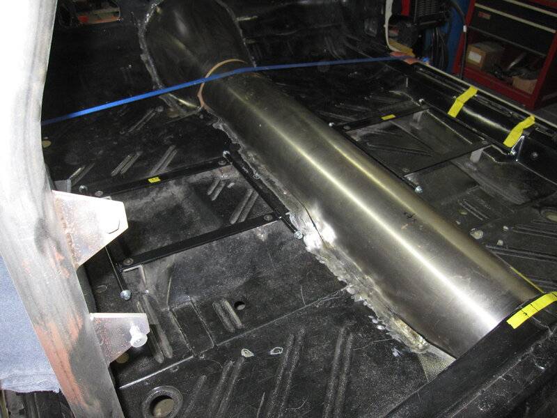

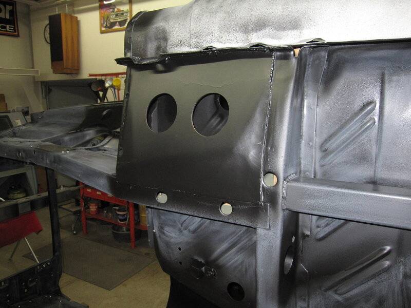

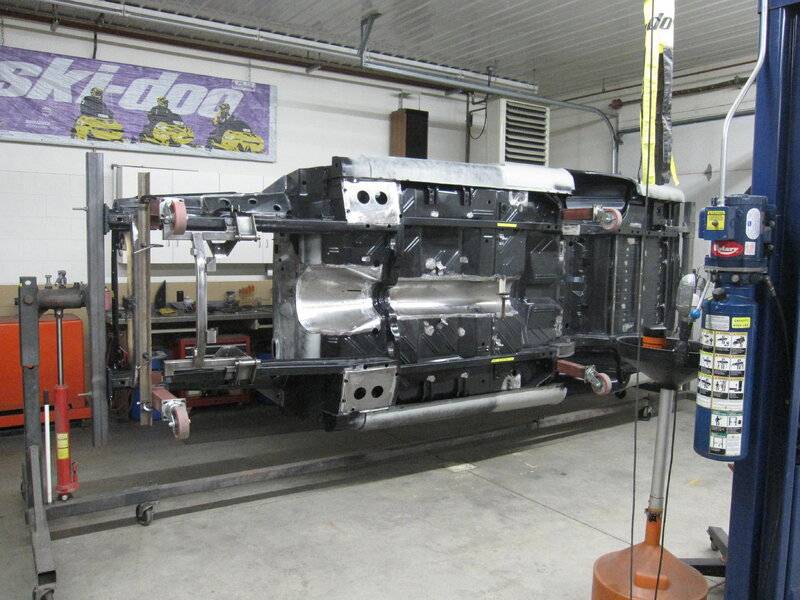

I tied the floor in on my 65. See the rectangles next to the front/rear floor pan junction. I also made front torque boxes and added USCT radiator support and inner fender stiffeners.
Mike
Very nice! Thanks, ill check out usct website. D
