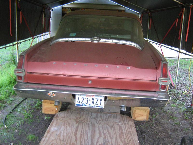

I did this last winter one at a time and had no problem with twisting. I used my air hammer with a chisel bit to separate the floor pan from where it is spot welded. Just be careful and don't attack it like a gorilla. Some of those spot welds can be a challenge to find. Then if anything is still attached hit it with a flap disc. Also protect your dash and windshield from grinding/welding sparks. Good luck.
03-24-2012 tailpipes installed.jpgI had used blocks made up of 2x8 boards where the car sets at a natural stance with the weight on the wheels.
