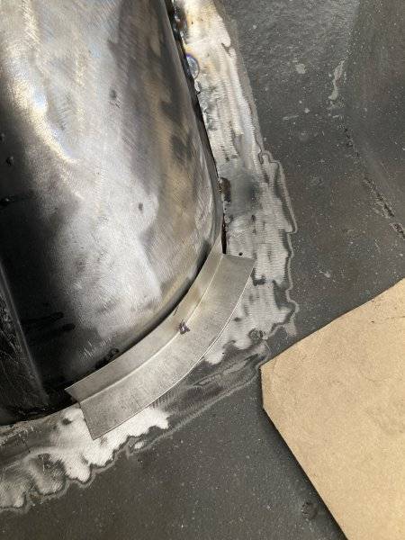

So what I ended up doing was cutting a section of floor to gain access to the inside of the frame rail. I then bent up some sheet metal to follow the top edge of the frame rail. Basically, I created a new flange on the inside of the rail. Then plug welded the frame rail and the floor to the new flange. I'm really happy with the results and think I have negated any loss of strength.
