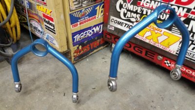

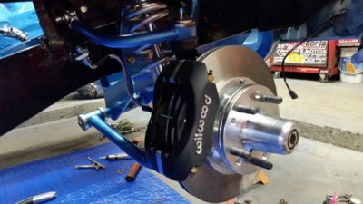

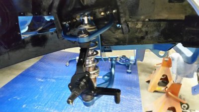

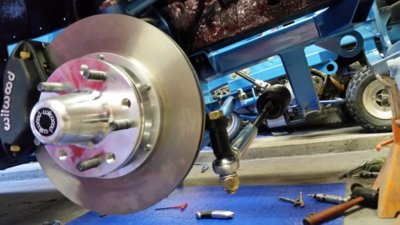

Just received my Gerst front suspension for my 64. Very nice pieces and everything needed looks to be included. I got the upgraded Wilwoods and paid $4455 shipped to the door. Figured I’d post some pictures of actual product received in case anyone was curious.
Looks like a quality product.... but at a hefty price.
Not exactly cheap, but it is the best value out of the few legit setups on the market. Also, you have to figure that almost $800 of that was brakes, which you'd need anyway, and another couple hundred was shipping. By the time I would've rebuilt my entire stock front end with some upgrades like uppers and torque rods, between the parts and powder coating I would've had close to $2000 in a stock front end - not including the brakes. So I was basically looking at $1500 difference to upgrade, adding easier and more tuning options, and shaving about 150 pounds of weight. If you've already got a good front end and are only having to upgrade a couple parts, this is definitely an expensive route, but in my case, I had a rusty front end from a car that's been sitting for a LONG time and I needed everything. That's how I justified it to myself at least :)

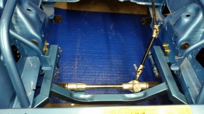

The RMS looks nice as well the only thing I didn't like about theirs was the fact that the lower control arm bolts aren't supported on the outside ends as was mentioned in another thread. As far as price difference, I dont think there is one it all depends on what options you get.
If I'm looking at the picture of the frame correctly, it looks like the lower arms are set up for a double shear mounting for their support. If so, thats something lacking in many other changeover units for the cars. Waay better rigidity.
I have seen them survive many wheel stands on drag cars. Now you guys have me maybe considering adding a gusset to the outer points back up to the framrails (just in case).
I know what your saying but in a wheel stand the force is coming down in the direction of the pivot and has the shock to absorb it but when you hit a pothole on the street some of that force is going to be transferred to the pivot bolts.
Looks like the Gerst will be another one to keep an eye on for possible use. I like the setup that Mike, 65 roadracer, is using and am watching for feedback on it while he puts it through its paces on the track and street. I'm leery of several of the Stang2 based units, especially at the lower control arms since the mounting is not very rigid. These are used in a lot of conversions for rods and other stuff. I've run into some problems with the through bolts being bent, even from basic driving/no dukes of hazard stuff, because there is a lack of support in that area. Over time, as we keep the cars and drive them, we will run into a lack of old components and will need to change out to newer styles so its nice to make informed choices for replacements as opposed to flashy ads. Years ago when I was at SEMA I stopped by the QA1 booth and spoke with the rep there about their components for our cars. Luckily he was a Mopar dude so he understood when I asked him: What happens when you put a floor jack under the new frame? As you all know, this is the usual spot for a floor jack. He said that as long as you catch both tubes, should not be an issue. Hmmm. Something to think about here. Maybe make a cradle for the jack so it bridges the tubes for better support and not bend them.
You are correct. The lower control arm bolts thread into the assembly and there is a set screw hole to insert a set screw against the bolt after assembly.
Somebody was thinking when they designed that unit. Unlike others who are copying someone else's homework and flubbing.
