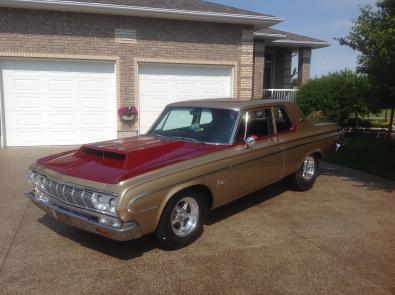

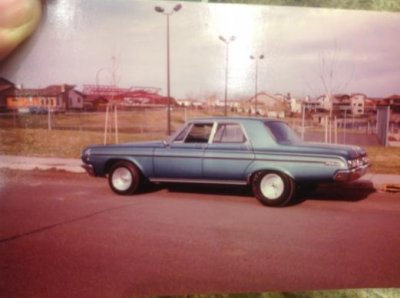

Regarding a 64 Dodge 4-door, I used to have a 64 more door way way back in the day that I did up with a big block with lots of good parts. I called it a sleeper but for some reason my prey were always suspicious. Here's a pic of my more door from about 35 years ago. That car was a lot of fun! image.jpg

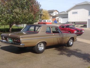

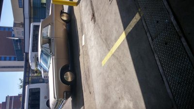

I love it. Grew up around mopars my whole life and really wanted a sleeper for my first one. I think the ugly gold really helps. I'll try to put a pic up.
Here she is.

Hey, gold ain't that ugly! :)

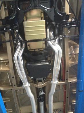

The newer style K Frame is effective to get your motor back a couple of inches. It's been noted many times in years gone by that a newer K Frame and SS Springs were the hot ticket for these old Mopars. This pic shows you TTI's and the newer style K Frame in place. Note the space at the pan and the K Frame. The collectors sure are positioned nicely on the TTI's. No problem with crazy pipe angles needed to get around the frame. image.jpg
