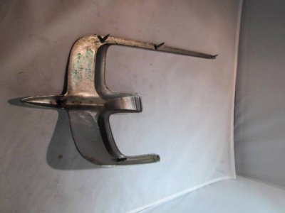

And here's a pic of the back of the Polara Bird. You'll notice there are 5 mounting points and I believe that just that short, center one near the nose of the bird is only one that's really threaded. The brass looking 'nuts' that go onto the long chrome studs tighten up on them pretty quickly with just a few turns. If you're going to paint the car and remove the fenders to do that anyway, I'd leave the Bird and medallions on until after you pull the fender. MUCH easier to see the hardware and access it with the fenders off the car.

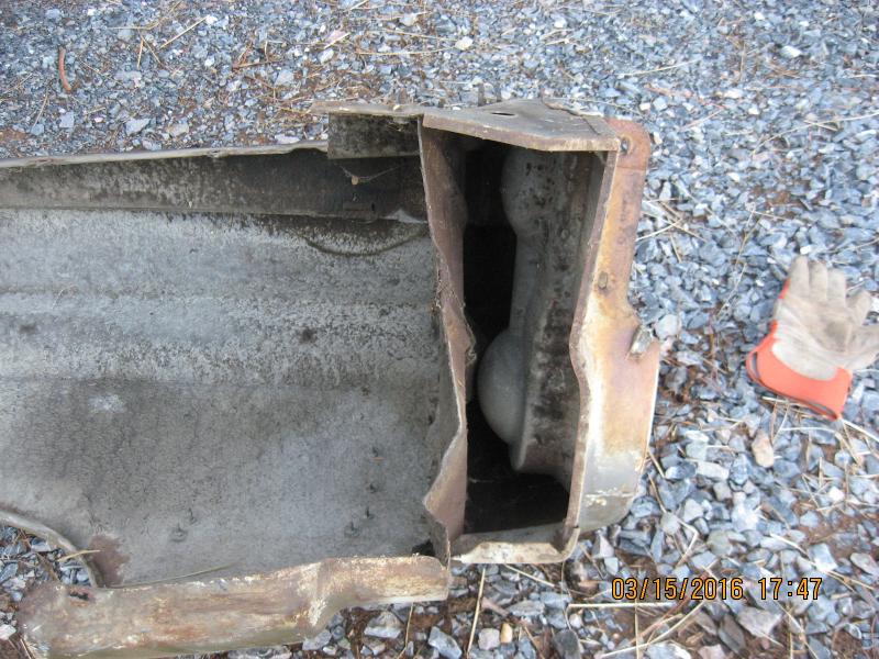

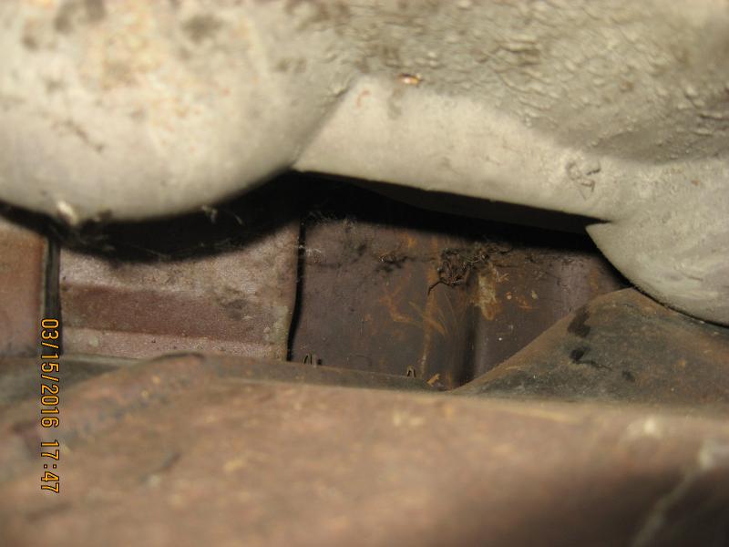

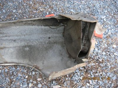

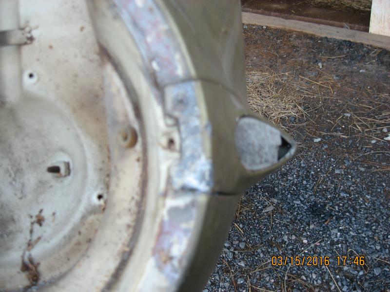

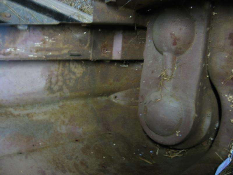

And here a some pics of 2 different fenders. In the one photo, I'm assuming you already found the phillips screw that's under the headlight surround trim? In the other 2 pics you can see the inside of fender, and with the front (metal) splash shield in place it's almost impossible to get to the stud and nut on the backside of the medallion.
On the red fender, the splash shield has been removed and you can see the hole where the medallion stud goes.
