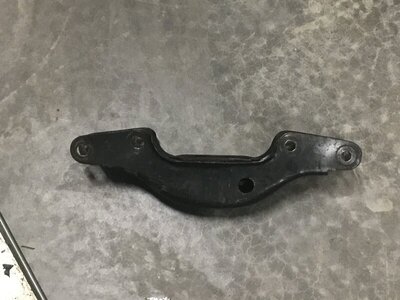

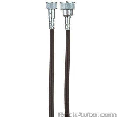

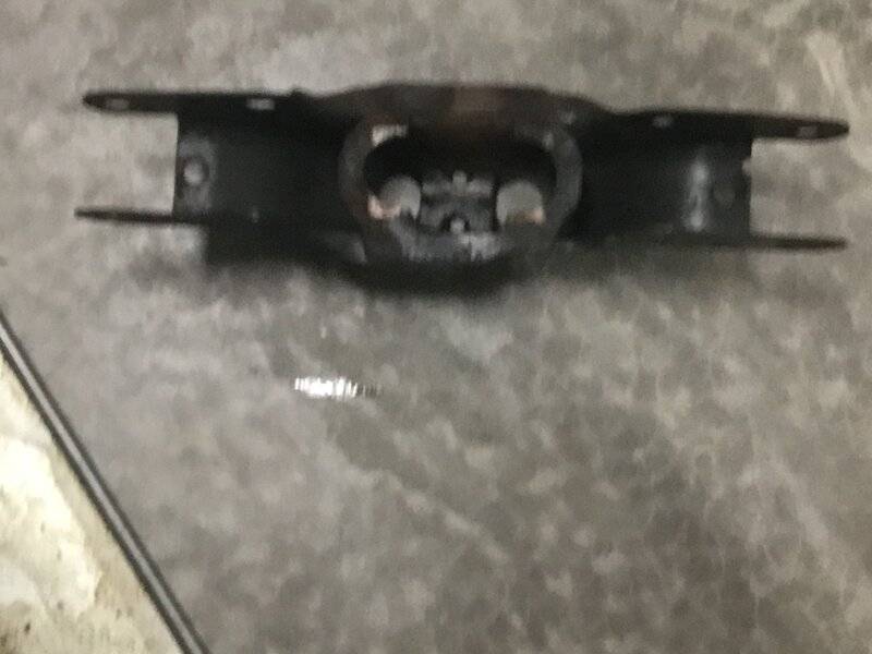

This is the cross member out of my 64 4-speed car and will work with the 68 tranny. You will also need a speedometer cable from a 66 or 67 b-body to make this work.
Here are the pictures of the cross member and speedometer cable.

just saw your pic's. do you have a spare cross member to sell ?
