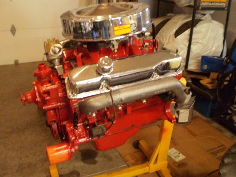

Are these the log style you mentioned? Here are some pictures. This is what's on the 383 now.
