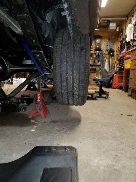

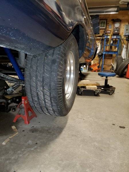

I just installed a 63 8 3/4 with new axles. Currently 4.5" backspace and could easily reduce to 4" now with these 275s. I could go to a wider tire if I wanted. The previous 70 rearend I installed was still a bit too wide.

My 63 has the stock taper axles and 3.23 gears. It's mostly a street car with street tires. Like Glenwood stated with the taper axles on my 63 the 4 1/4'' back space wheel put the 275 tire(on the passenger side) a bit too close to the leaf spring for my liking. Ma Mopar had a + or - tolerance so not every car was the same. A 4'' backspace wheel would work nicely. I have heard that a 325 tire is just about the limit though I never tried them.

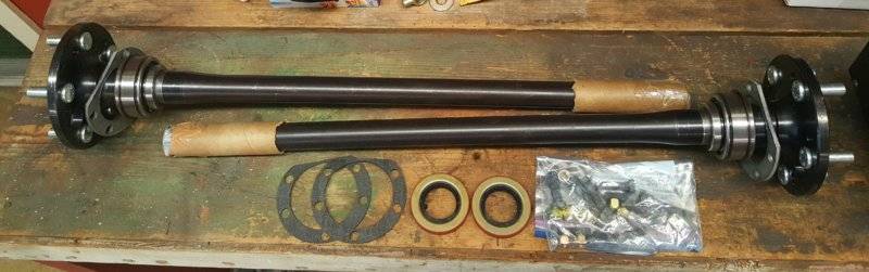

Bought replacement axles from Dr Diff to replace the taypered ones from my '62. Had to use '70s backing plates for the newer style, pull off drums. It allowed me to keep the original housing.
