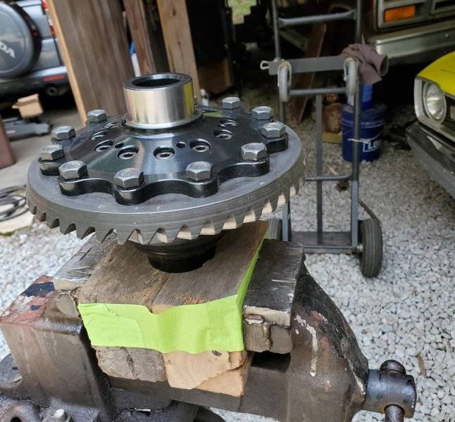

Mopar 8 3/4" (8.75) Helical Gear Sure-Grip ("Sure-Trac")
I have the 4.10, 3.91, 3.55, 3.23. I like the 3.55 but prefer the 3.23. I find the 3.55 still scream at highway speeds but the 3.23 do not.
