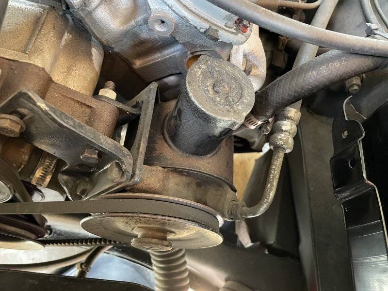

Like an idiot, I didn't take pics of how the power steering pump mounts. Can I get some good clear pics of 273 power steering pump mountings on the engine?

You do have to retain the early cast water pump for the power steering mounts on the early B Body pumps...
Sometimes guys install later 360's or something and use the aluminum water pump...it works fine for manual steering but not power...
You can swap the pump but then the dreaded timing marks behind the pump exit and the difference in the size of the intake bypass hose problems arise...

Yes, I installed the older cast water pump. Everything lined up fine.
