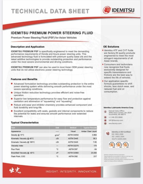

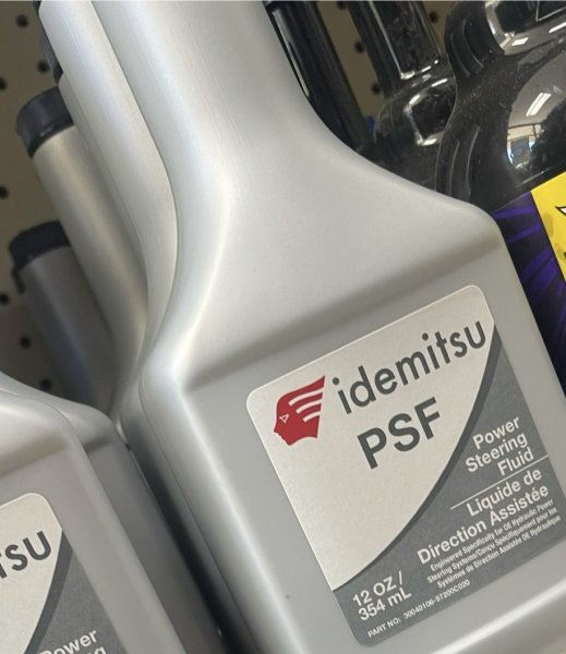

I have what I believe is a power steering fluid pump leak around the outside ring gasket area of the front face of my pump. I’ll probably just get a remanufactured. I used idemitsu fluid to fill have not run under power with car running. Do you think this fluid caused it? Pump is original and been sitting. So may have been faulty before. I’ll attach the fluid data sheet.
I doubt the fluid caused a leak.. however, I wouldn't use the Honda/Acura specific fluid. Take the can off and replace the big oring.pay attention to the surface the ring seals to. Fill with Dex II/III , ATF+4. Or ugh, the chevy PSF.
