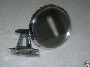

When I purchased my car a while back, the driver's side mirror was not attached, although one was in my box of parts. The holes in my door are 4" apart, but the mirror holes are 2-3/8" apart. The mirror is a twin post and looks similar to the one in the Classic Industries catalog. What's wrong here?
you might need a remote mirror-totally different base on it

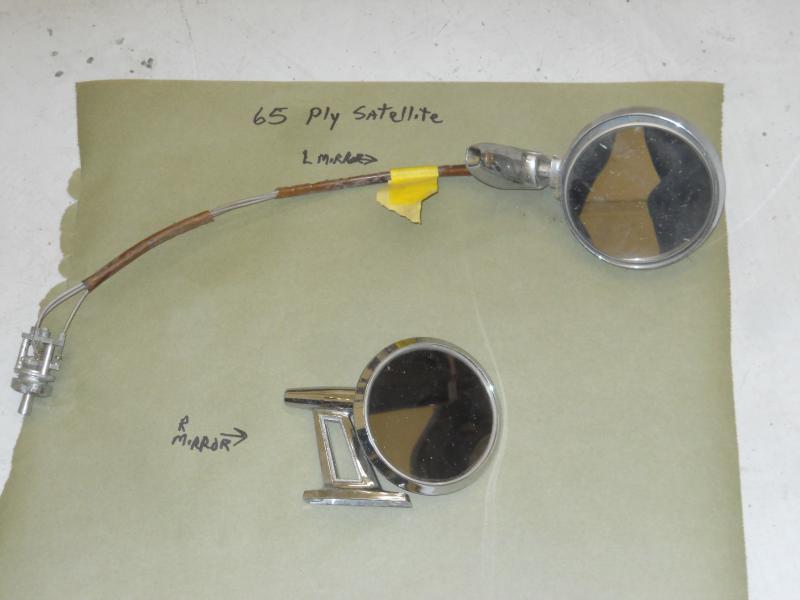

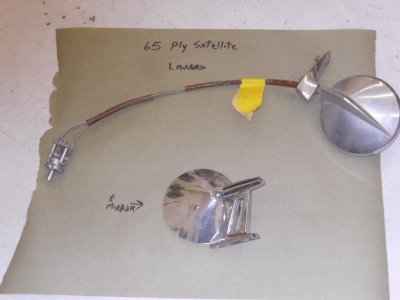

my 65 satellite is the same single post on the left which is remote and a twin post non remote on the right both have 2&3/8" spacing and both are for sale the chrome is decent I am going with different mirrors other 65 satellite available. I am putting a 3 deuce set up on my 318 and later a stroker. the 3 deuce set up going on just to drive around with003.jpg001.jpg002.jpg
