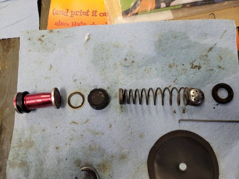

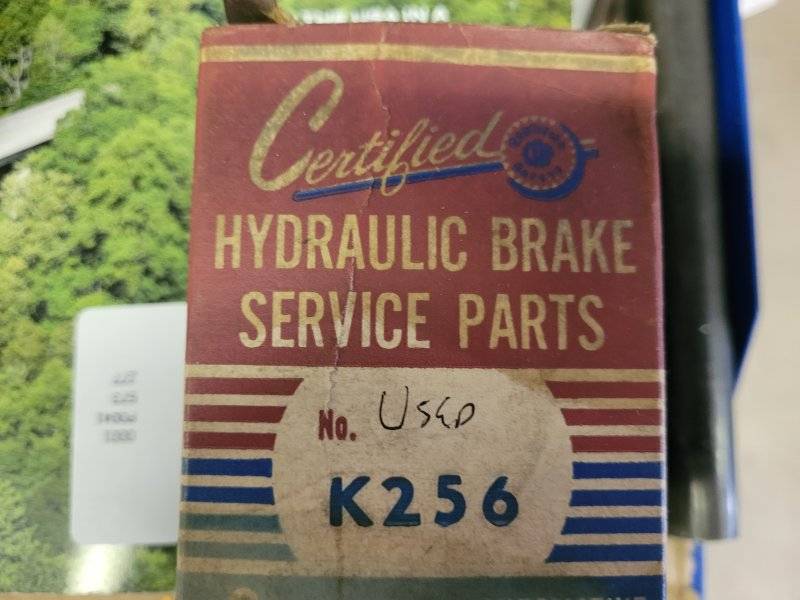

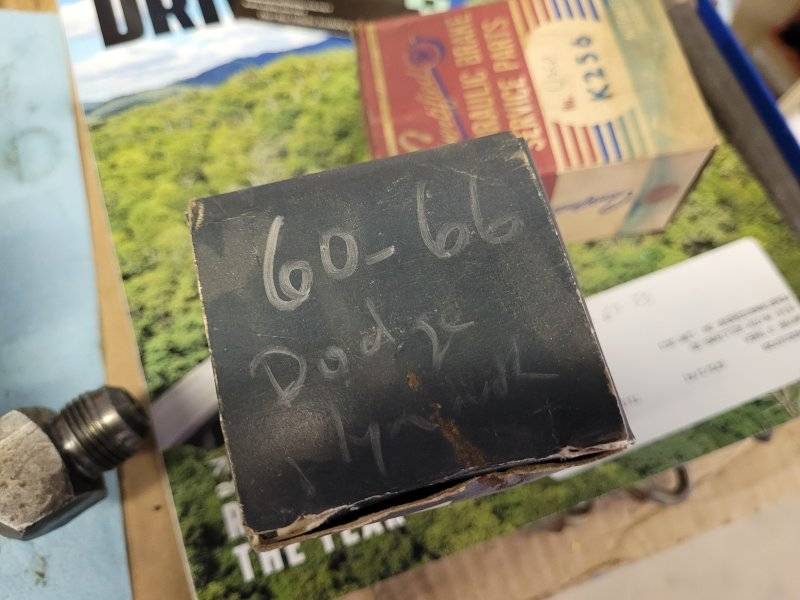

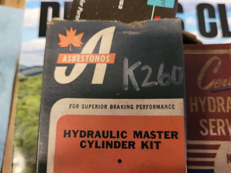

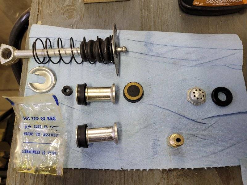

Kits are still out there, I'll try to remember to get a part # for you off the boxes I have on the shelf...

I gave you part numbers that work 2 weeks ago, start looking or post a WTBuy in the classifieds.
