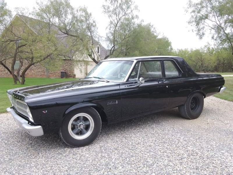

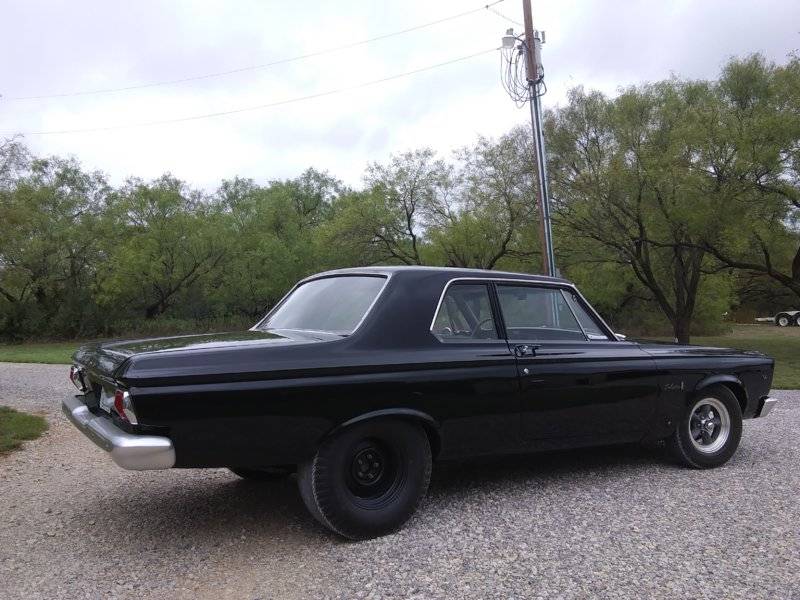

Good looking car! What size and brand are your rear tires?
They're Firestone Dragster 8.20-15. They have that period look, but good god they are heavy! And they don't bite worth a crap. I'll definitely change to the Goodyears or Hoosiers at the strip.
Well then back down to 18*. It seems to be the magic number for most of the BB builds.
I'm leaning towards staying at 23°. Starts easy, no kick back, no knocking, runs strong. The vacuum falls off 1.5" - 2" hg when I set timing at 18°. I guess it is what it is.
streetwedge, that's one good looking car. you have done a great job looks race ready just setting still awesome work.
