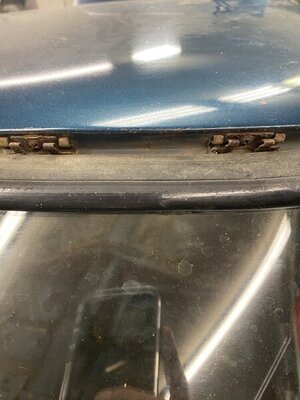

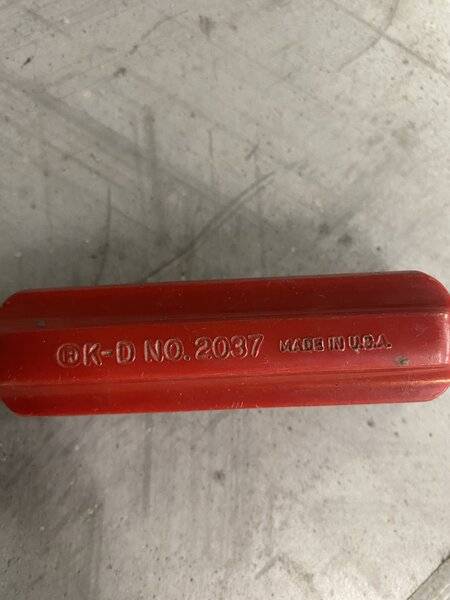

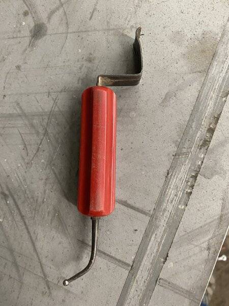

Have successfully removed all the trim on the 500 except for the rear window trim. Front and sides were relatively easy. Based seems to have the spring loaded clips. Purchased the GearWrench 2038D tool but the hook seems too large to get behind the clip. Anyone have any recommendations on how to remove it or a better tool?

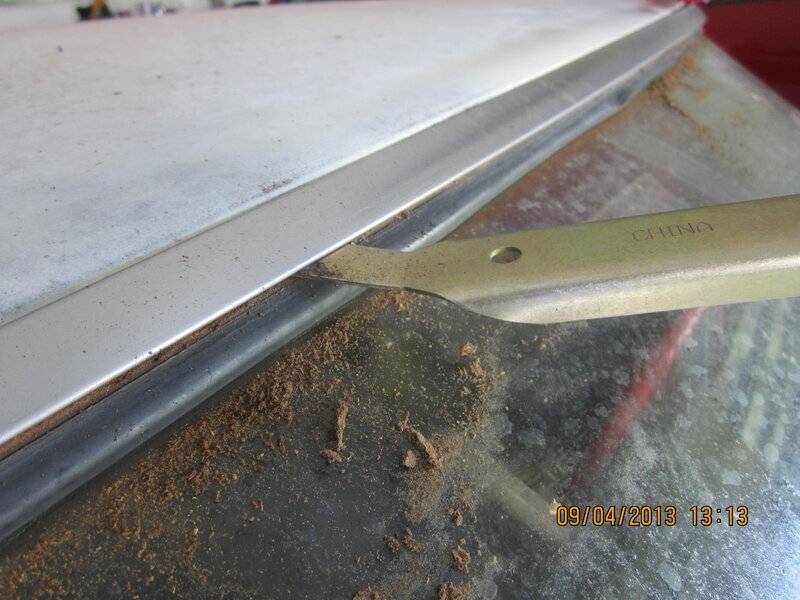

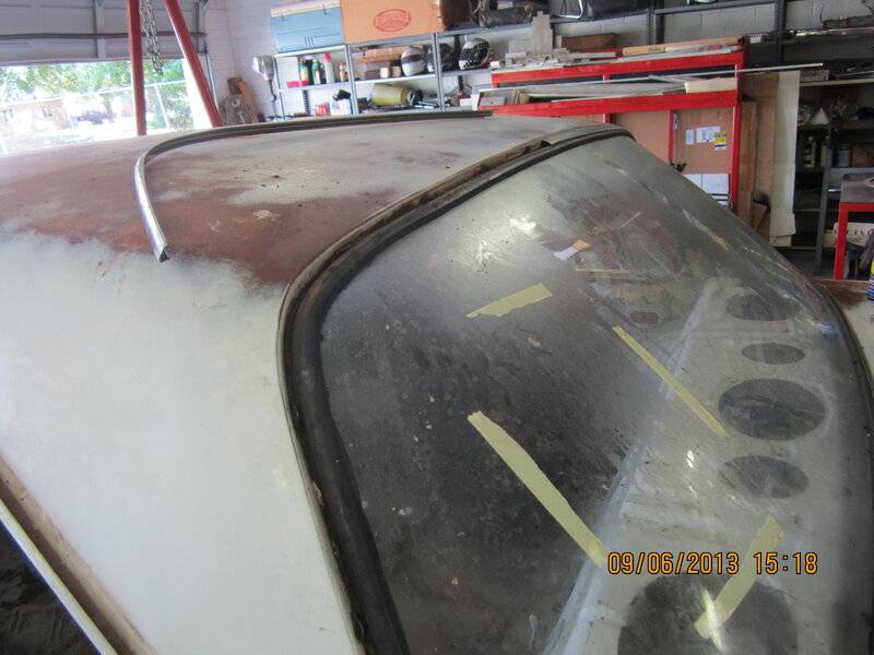

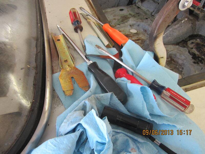

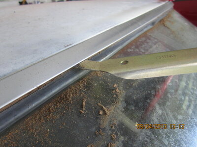

I did this years ago, don't remember all the details. The Gearwrench tool did not work. I used an assortment of tools. Took some practice to get the tool in the right spot. Removing the front windshield trim is the same procedure. Both use the same retaining clips. The arrow pointed tool in the photo is the one that worked best.

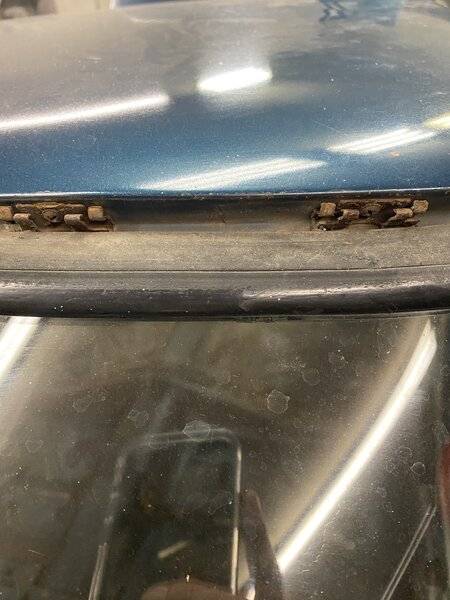

Thanks. I found an older post on a Belvedere after digging in google. Search on here didnt pick it up. Odd for some reason the front on this car is completely different. The front just snaps in so to speak. Will grab a picture later today and post it. I was able to get one off the back but boogered up the lip on the trip lightly. Was attempting to do exactly what you showed above and was getting leary of breaking more of them. Thank you.
Odd, I worked on the rear a fair amount to no avail. Attached is a picture of the front. It was super easy and popped right out of the clips shown.
