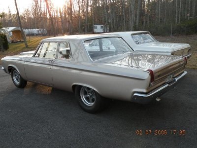

I have 275/60/15's on my 65 coronet. They are on American racing torq trusts with 4 3/4 back space and there is no room to spare. You could get a custom wheel with a 5 inch backspace and he might be all right but a custom American racing torq thrust is about $400 .
mine
