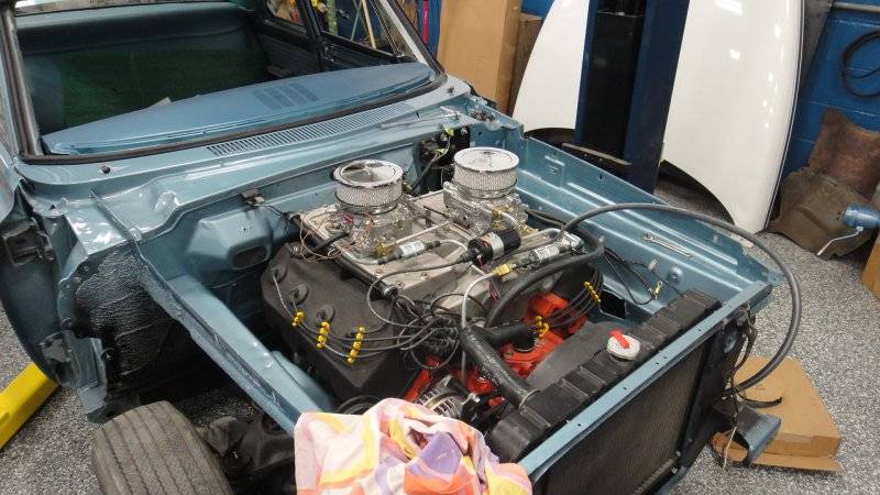

Not the best photo of my 63 318 using a 26'' rad from a Cordoba.
Tough fit. Had to relocate holes of the mounting flange.
Also clearance the bottom rad support some for cap hood clearance.
The rad support opening is large enough for a 26''
The photos of the 65 blue car that was a slant six we went with a OE 26'' rad from a Hemi E body
using the stock rad support.Again relocation the Flange bolt holes.
Best I can do with photos for you.

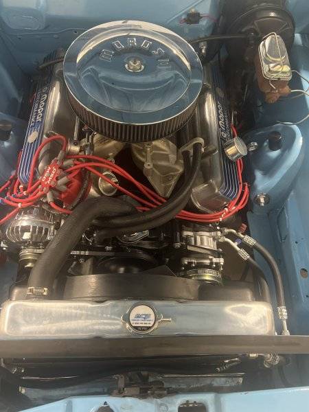

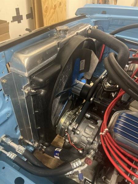

I installed vintage air in my 65 Coronet this past year, 383, 9 to 1 with a comp xe284h.
I went with an ECP 22” radiator, 18” 6 blade fan, 180 T stat, A-body fan shroud (classic industries ma2228), and a fan spacer from jegs. The car stays around 190 at idle (in traffic) with the a/c on, 85 deg outside. Once you start moving the engine drops to 180 and the thermostat will actually cycle open closed.
I’m sure your set up will work just as well!
