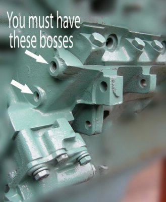

440 will bolt in but you need the specific 1965 B/RB engine mounts. Also, you will need specific C-body headers unles you use 'shorty headers or HP exhaust manifolds.
The 65 C-body B/RB mount on the driver side is diffeerent than most others in that it bolts to the front 'corner' of the engine block (I think the 66 was revised but I am uncertain) In fact, the 65 C-body engine mount is the same one used for the 68/69 A-body with big blocks.
Check the attached picture for where the mount bolts to the engine.
Most 383 blocks have these pads, not all 440 engines have them.
