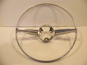

I know that those wheels look straight across but look at the horn ring. The horn ring isnt straight across. They're three holes in a triangle orientation. Would this be a good reference to make a conclusion? Does this look like the one you have? ( I'm thinking this horn ring is upside-down.)

Kid, no horn ring installed yet, just mocked the steering wheel as shown.
