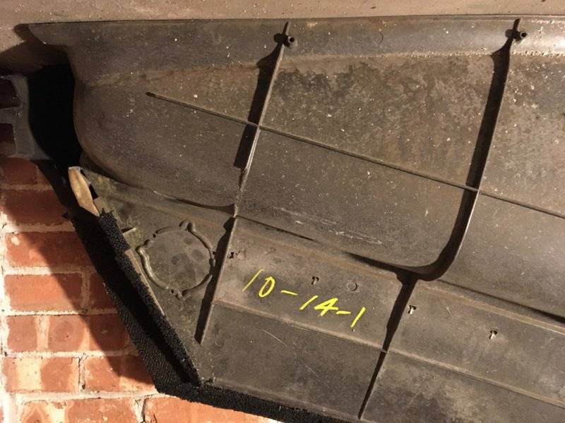

The rear passenger side sail panel area cover has a factory cutout for the defroster molded into it on the back side of the panel for this option, and the part is mentioned in the parts catalog. It was a very poor design however, so even if someone were to special order it, it would have been pretty useless.
I have a picture of the molded cutout on my PC at home. Unfortunately, I'm not there at the moment.

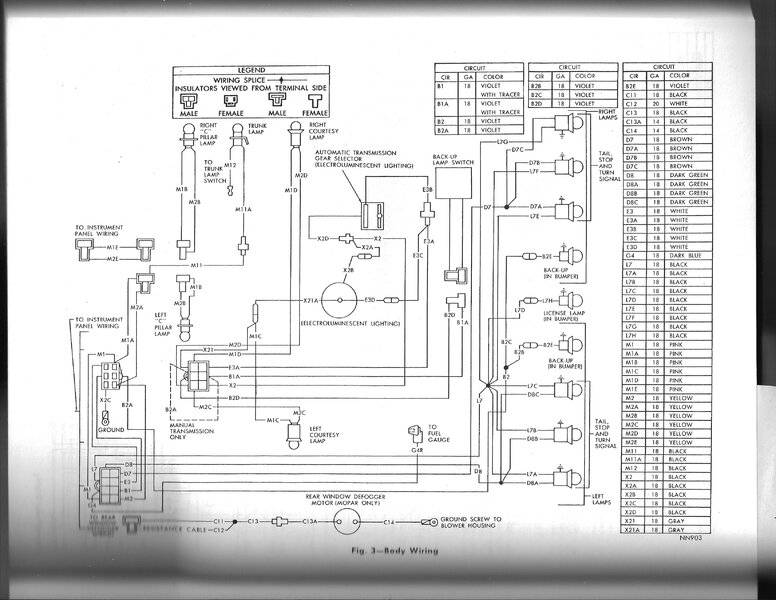

This is a scan of the Charger rear wiring harness from a reprint of the 66 FSM. At the bottom it shows the harness for a rear window defogger with the caption "Mopar only" which might mean it was dealer installed.
The word might is key. We've still seen no photographic evidence one exists. I'd like to see that one day.
Wonder if that was just an idea and did not get much further than a dealer having to figure it out if needed. Ranking up there with some of the 67 books showing the hood release pull from 66.

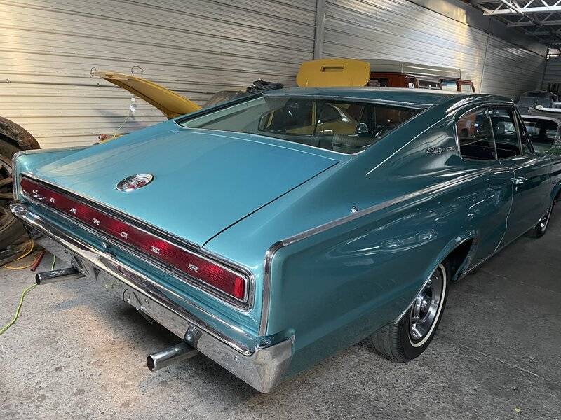

Recently acquired 67 from original owner which according to tag was factory built for him. There are a few odd bits- factory air, 4 spd 383 with console delete. What’s interesting is the antenna- I’d be curious to look under fender to see if the OEM has been filled; but look at attached photo. And there is a toggle like switch on bottom of dash, which looks quite old. Car is in winter storage so have not really investigated.
Recently acquired 67 from original owner which according to tag was factory built for him. There are a few odd bits- factory air, 4 spd 383 with console delete. What’s interesting is the antenna- I’d be curious to look under fender to see if the OEM has been filled; but look at attached photo. And there is a toggle like switch on bottom of dash, which looks quite old. Car is in winter storage so have not really investigated.View attachment 1196146
We had a 67 383 auto LL1 came from the original owner. Car came to the dealer, with the radio and antenna in the trunk. Dealer said where do you want the antenna? The fellow said right rear quarter. There were templates supplied so the dealer would know where to mount the antenna on the front fender. Pretty well guarantee that there won’t be a hole in the front fender.
