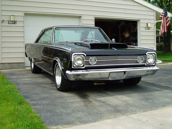

I actually prefure the single head light look of the 66 with the turn signals in the grill. My vote would be 66 Bel with side trim removed, flip to gas cap installed, 67 Sat interior, GTX scoops and leave the rest alone.
I'd say RO23 scoop instead of GTX scoops, but that's just me.....
