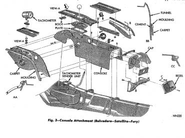

I've got a 66 plymouth service manual. I'll see if there's anything different with the console that looks obvious.
I just looked at the manual and ChargerPilot is absolutely correct. The console is two pieces and the second piece attaches just after the glovebox where the console turns up. I learn something new every day. Attached is a scan of the console page.

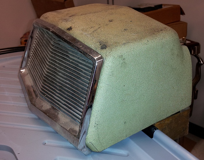

I took a picture of the rear part so you can get an idea of what it looks like...let me know if you need a picture of the front piece.

the other obvious difference is the 66 is a much thicker plastic body than 67 and up bodies.
in my opinion a better feature.
