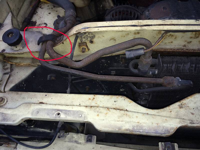

Putting back together my '66 Belvedere after completed body and paint work. Anybody know what this is called and/or where I can buy one? Mine's old, as you can see from this pic before restoration, and I'd like to replace it.
Thanks

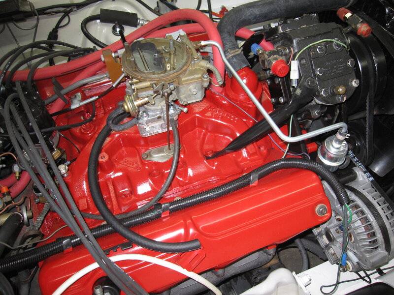

You could strip the rubber replate/refinish the exposed steel and recoat the rubber with the liquid rubber they sell for tool handles, etc. I can't remember the brand name (old farts disease). I used this on my poly engine spark plug wire holders on the valve covers and the wiring harness clips, and the hood safety release handle. Very pleased with the look.
Mike
View attachment 993779 You could strip the rubber replate/refinish the exposed steel and recoat the rubber with the liquid rubber they sell for tool handles, etc. I can't remember the brand name (old farts disease). I used this on my poly engine spark plug wire holders on the valve covers and the wiring harness clips, and the hood safety release handle. Very pleased with the look.
Mike
Great idea. Thanks
That's what I did for the wire harness hold downs on the fire wall and brake booster on my 73.
Came out real nice.
Plan to dip it at least twice or 3 times and don't wait so long between dips that the plastic doesn't bond with the previous layer.
