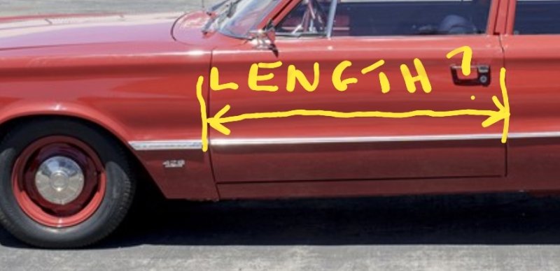

Hello everyone,
could someone possibly share what the length of a door off a '66 Belvedere 2 door sedan is?
I am thinking of a 2 door sedan conversion but can't source a stock pair of doors here in Europe therefore would be fabrication involved, hence the size needed.
Trim line seems to be the best area for measuring it, I think. Correct me if otherwise.
Thanks in advance and cheers.
Bat Miro from Bulgaria.
I can measure mine.
But its 2 door hardtop if they would be the same
I have a couple doors for a 2 door sedan which I could measure.
BUT-
It seems like making a longer door would be nearly impossible.
The upper frame sure would be tricky.
Would you be getting glass from other doors?
Thanks for the inputs.
Don Frelier, please measure one of yours two- door sedan doors.
I have two bottom- rotten 4 door sedan doors suitable for upper frame extension donor.
Glass can be made locally to fit the modified door and quarter opening.
Thank you all.
Cheers from Europe.

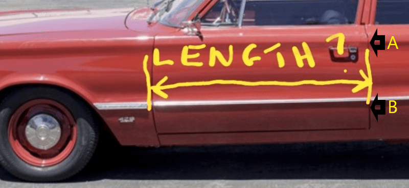

I measured at the upper crease line above the door handle and at the lower crease line
A = 40 - 3/4"
B = 41 -1/2"
