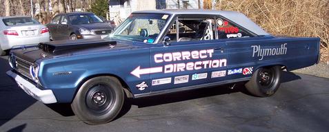

Great News!! Headed in the correct direction!
