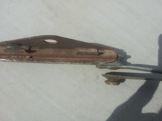

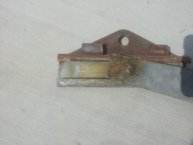

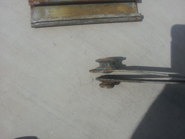

Well, finally tore into the glass install and did not find what was described as a "plastic button holding the plate and glass together". I did not see any means of separating the glass and the plate it was mounted to without removing the entire track and regulator mechanisms. After 3 hours of partially disassembling what I could, I finally gave up. If ANYBODY has any helpful input, or can pint me in a good direction, I would greatly appreciate it! I've searched the web for days, and haven't come across anything. I could provide pictures since I still have the back seat and panel removed.

Sorry you are having troubles. This is what all the ones I have taken apart look like. The triangle piece is attached to the glass with the plastic rivet. Then the glass and bracket slide onto the blue roller. Sometimes cranking the window up or down will let you slide the triangle bracket off the blue roller but I have found it to be too wide to get through the opening together like that.
Wow....mine looks nothing like that. No wonder I couldn't see it. Is that from a 66 belvedere hardtop? I ended up getting it out, but pretty much had to dis assemble the whole damn works to do it. Now I need to get the glass out of the frame.
