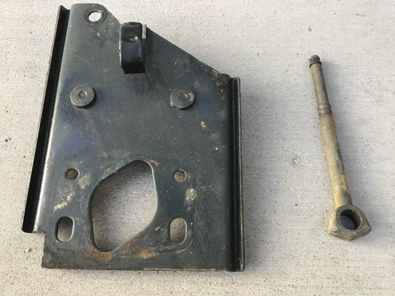

Bolt pattern is the same. However you need a different firewall plate than the power brakes, and a manual brake pushrod. These are the same from 66-70. You can use the stock single master cyl or switch to dual reservoir with the same parts pictured.

also just checking mine out looks like pic..is it a different thickness?
A factory power brake plate has a round hole up higher. It won’t have the oblong hole like in the photo above. I can photo a power brake plate if you need to see it.
The outer shape is the same on both.
