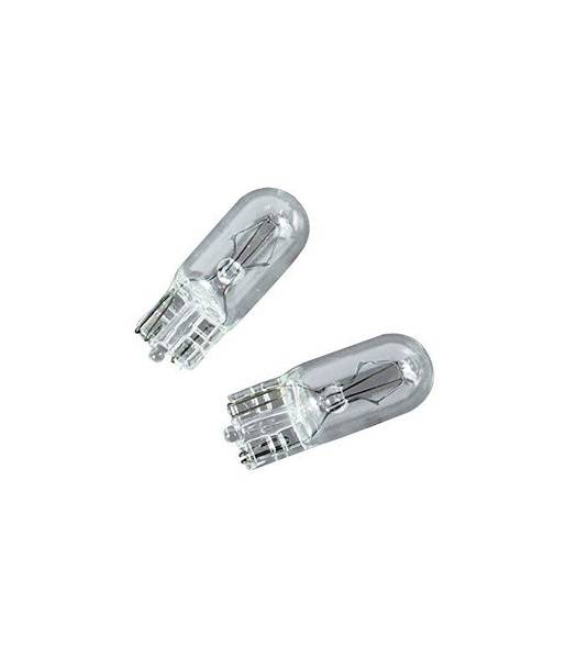

#158 bulb
sockets for bulb - any parts store (pricey). Check the internet you will find them cheaper then the parts store price
#158 bulb
thats not the correct bulb. they are tiny little round light and round bases thet push in and turn to lock. i cant make out the writing on my origional ones.
