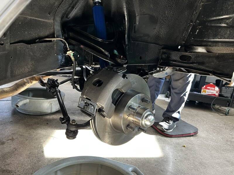

Pics below. I just did this on my 66 Charger with one of the power disk brake kits that cost about $900 for all the parts, I wasn't worried about "original mopar" parts though because I just wanted good safe breaks so the car is a pleasure to drive and I must say I achieved that. Other than buying the brake kit the other significant change was wheel size. The brake kit requires 15" wheels for clearance and the stock wheels are 14". After all said and done, I would highly recommend it!
If this is a route you want to take let me know and I can provide specifics on parts as well as wheel/tire specs that I went with.
