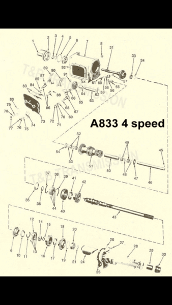

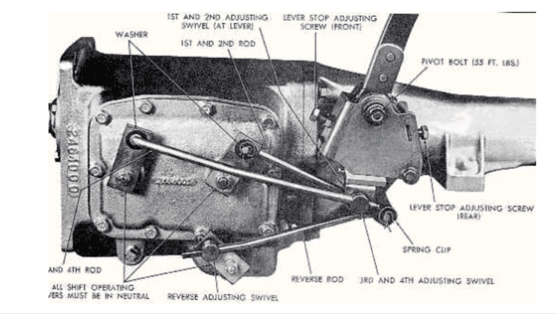

looking for a parts break down for the 66 charger four speed shiftier my reverse lockout is not working
Hello, something like this?

Welcome from Canada,does your shifter have the "T" handle you have to pull up for reverse? If so you probably need a new cable,readily available in repro
