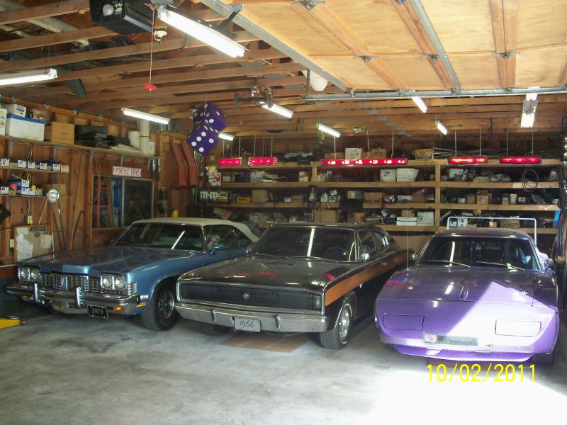

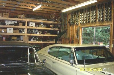

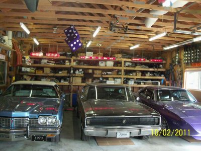

just a small sample of what I have collected since 1974
Bryan

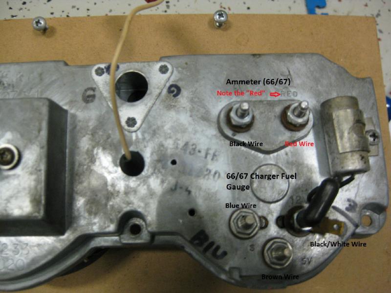

Dog, take some pics of what you got going on there please.
condenser, suppressor, whatever it's called..it's not the limiter...the limiter is built into the fuel gauge, that's why there are 3 wires on gas gauge

I know who I'm going to become friends with when I start doing over my 67 440 4spd Charger!

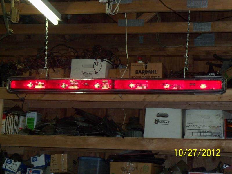

had some spare tail lights around for my cars...I did something with them
Bryan

Bryan has some serious spare parts! The condenser attached to the post on the 12V side of the gas gauge is for dampening the static produced by the points type limiter in the fuel gauge (for the AM radio). With a solid state limiter installed (removing the points limiter in the fuel gauge , that can then be tossed)...More than likely the points limiter in the fuel gauge has failed, which also supplies 5V to the oil press and temp gauges. The bad part is that when the points limiter fails, it more than likely put way more than 5 V to your three thermal gauges and cooked the insulated nichrome wire in them. First they will become unreliable (calibration will be off) and then if the wire gets cooked enough, will fail altogether. I have restored close to sixty 66/67 gauge clusters since I opened for business back in 2009. I own both a 66 and a 67. Be glad to help if you need any more advice or rebuilding work, my contact info is on my website, www.thegaugedoc.com.

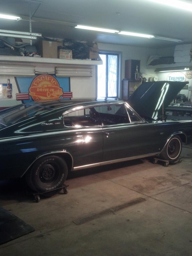

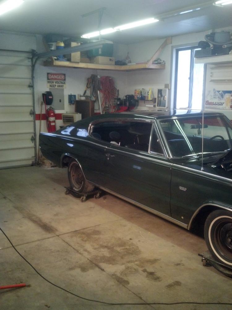

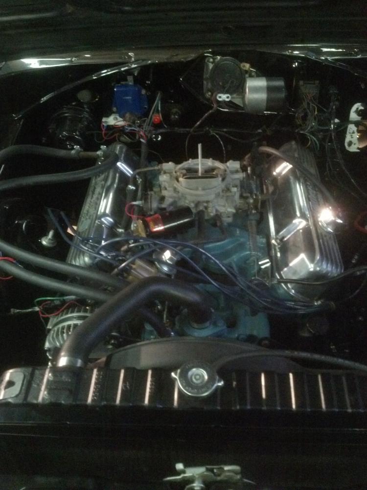

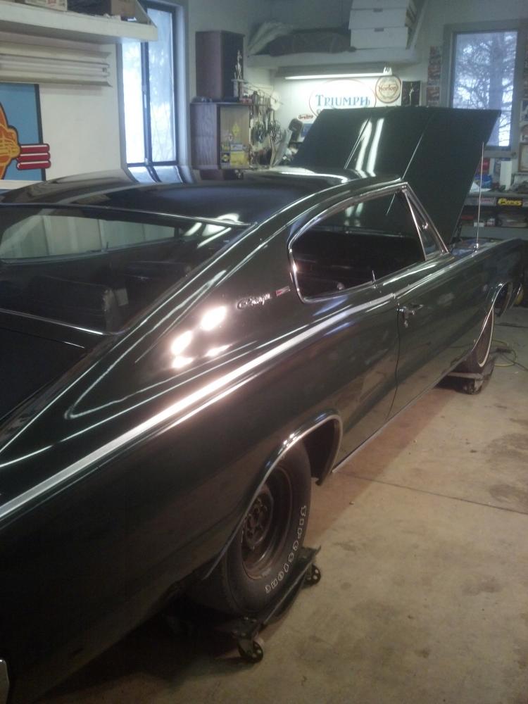

someone wanted pix so here they are. heres the story with this car:
to look at it its nuthin special EXCEPT..there is absolutely no rust or rot on this car. when i met my buddy and this car it was DEAD. he had the motor and tranny built 10 years ago and it sat for that long without being started BECAUSE.... someone cut ALL of the underhood wiring and my buddy had no idea how to wire it back up, so it sat in this garage for 10 years. i spent 3 weeks tracing and rewiring this car. installed new style charging and ignition systems ( stock Mopar ). when it was time to fire it up....i poured a bit of gas in the carb and it immediately came to life with no hesitation....didnt sputter and die....it stayed running on the first turn of the key. its a 383 .
as far as the gauges BRYAN...i kinda figgered that too..being that if the wires were all cut....something bad was bound to happen. but the electro-luminescent lights work and we have all needed after market gauges in there. heres a few pixx.
