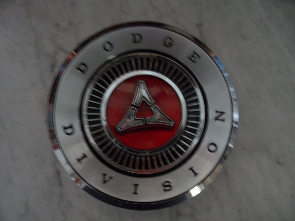

Well as it turns out, I decided to restore one I got from a friend as the whole medallion I originally had was in poor condition. The one I got was in need of restoration too but was a better starting point than mine.
So I cleaned the large chrome outer piece and hand painted the little lines, letters, and rings with black enamel paint. Took the inner emblem with the fratzog and polished the plastic on the top then removed the remaining old paint or coating from the back of it. The wife had a nail polish that was the exact same color as the original red and she painted in a circular pattern to mimic the original design. I then coated the back with a silver/ chrome paint and it came out like it was Brand New!
I am tempted to put out a shingle and do the medallion reconditioning for some extra money. If there is such a thing!
I will take a picture of the medallion and post it.

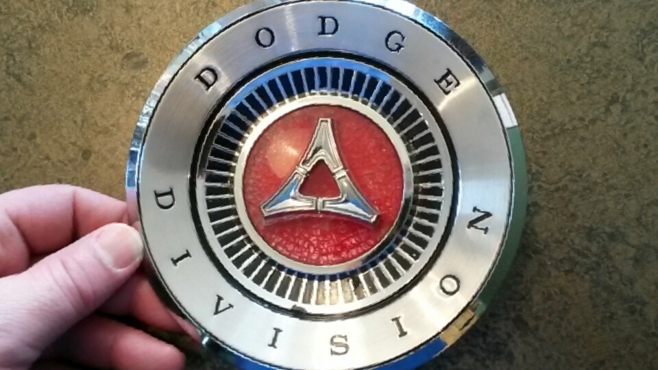

This is mine that I fixed up last year. The center was cracked up but that doesn't matter it matches the patina of the car. I just sprayed the back side of the the Fatzog. Masked and cut out all the small dashes around the Fratog. Sprayed the whole thing black and wiped off with thinner.
All the mounting studs were broken off so it's held on with lots of RTV.

This is mine. Sorry for the blurry. I must have it on "Yeti" mode. LMAO!!
This is mine... I found it on the back of some farmers field car. It wasn't bolted down or anything, it just had some RTV holding it in place.
Chances are it was just going to fall off sooner or later anyway.:)

Somehow I think you're not telling the truth? Pretty amazing what RTV will hold.
