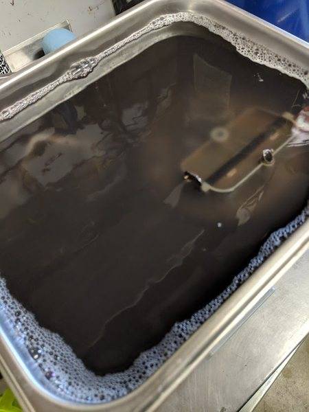

Anyhow, I thought I'd make a thread to document my progress. I haven't had a whole lot of time this week, but some parts are on order and I've already ironed out a few niggling items. The PO complained that the carb was rebuilt, but had never run right - but the vacuum choke advance looks completely pitted and rotten, and was definitely sticking. In either case, this seems to be the original carb on the poly 318, and I've got a Holley 500cfm 2bbl laying around unused from another project. Even the adapter plate looks like it'll match up. I disassembled the Holley and the insides were actually not bad at all. Still, I somewhat recently bought myself a heated sonic cleaner, and this seemed like the perfect opportunity to put it to good use. I dialed the water up to 60C and added some of the aluminum-safe formulation of simple green (actually purple...) and immediately watched the water go from clear to black and watched the little bubbles of cavitation doing their work. The parts came out *perfect* after 30 minutes, with only a few bits of stuck-on paper gasket to remove with a fingernail.
