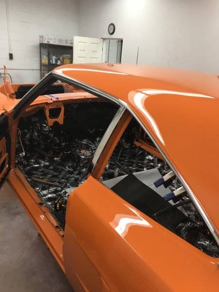

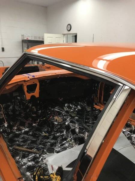

We are just putting the trim back on my car and I can honestly say the time spent on the wheel was well worth the reward. Every time I was buffing I thought my back/neck was broken from looking down. It really makes the paint pop. The details are what separate each car.

Any tips on installing the drip rail trim without bending?
Top edge on first then it’s a pushing down while using a down and toward inside of car motion. Bump down with your palm.
Put a light film of grease or Vaseline on the bottom of the drip rail before you start installing the trim.
