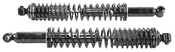

ive got a 66 charger 361 4 speed all stock. What are my rear shock options? It still has the original leaf springs and I don't want to have any rear sag issues. I'm not wanting to re arch springs yet.Are air shocks my only option for now or is there something else with adjustable ride height that will also "ride" nice?
these could work for you
58577 Monroe
Gas charged shocks actually have a little outward pressure.
How does it sit today? If it's not too low then put a good set of gas units in it, maybe lower the front a bit and minimize the weight in the trunk etc.
Then drive it as much as you can.
KYB is probably the best for your dollar, but there are several good types available.
Monroe has a shock with a helper spring. I have them on my charger. part#58577 They picked the rear up about 2". They ride nice too. Pat
