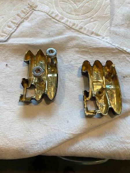

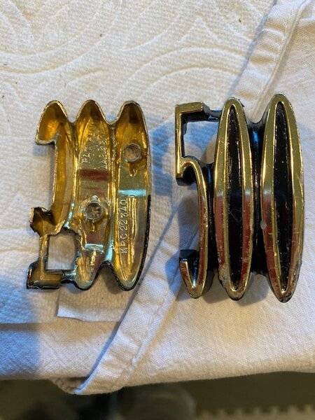

Hi Guys, did a little work on one of the doors today. Then noticed it had over spray on the inside. So, sorting that out. I got out some of the badges that I worked on 3-4 years ago and was reminded that one of the 500 badges that goes on the front fender lost its prongs when it came off the car. So, what to do?? I noticed that the "good" prongs were, it looks, glued in. So, I have tried to find something that might work to replace the lost prongs on the second 500 badge. I cut the heads off a Number 8 Stainless Steel Bolt and glued it into the hole with some Outdoor Glue. Anyone try this before? Your Results? Here are the pics.
I'd recommend JB Weld instead of any glue.
