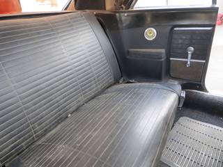

Hey guys I was hoping someone might have some nice pics. Curious too if the panels slid into a screw on chrome trim. This ones a convert so if you had pics of the rear would be great as well thanks

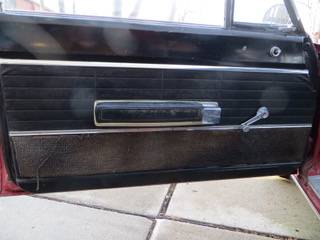

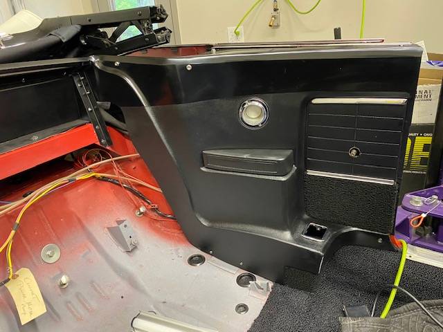

I have a bit of work to do on my Front Door Panels, but perhaps you can get the idea from these pics. From 66 Coronet 500 Convert.
Driver's side Front. These are Originals that I am working on bringing back to life. Have a bit of work to do on the vinyl around the lower edges. Backs coming.

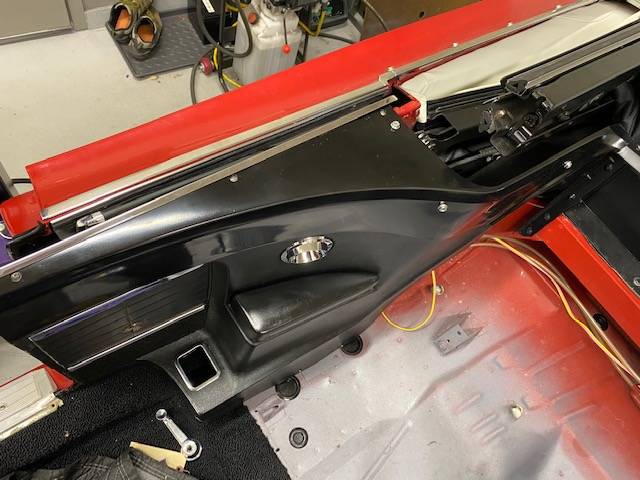

Just installed them this week. Again, Originals that I rebuilt. Don't have a view of the inside, but you can see the inserts towards the front. Notice down real low some carpeting just at the bottom front. Let me know if you have other questions.
