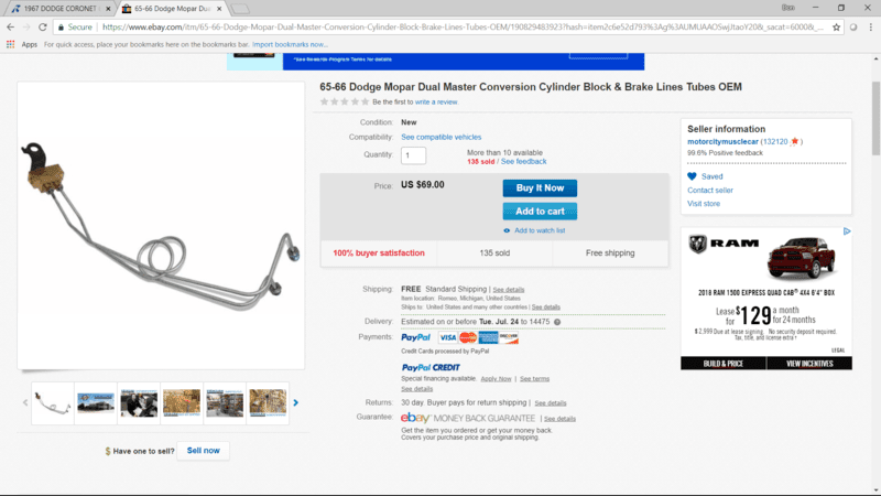

You need a conversion brake block and lines to go with it. The rubber lines should be replaced if original as well, but all together these parts are not super expensive and worth it, cheap insurance really. When I get a chance I'll post a suggested parts list.

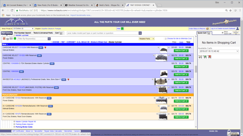

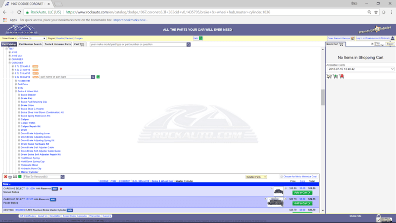

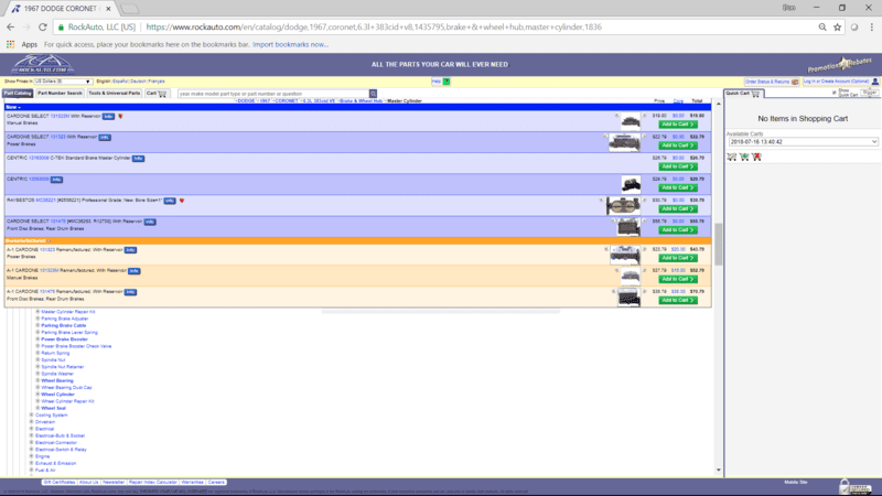

Need to get a manual or power master cylinder

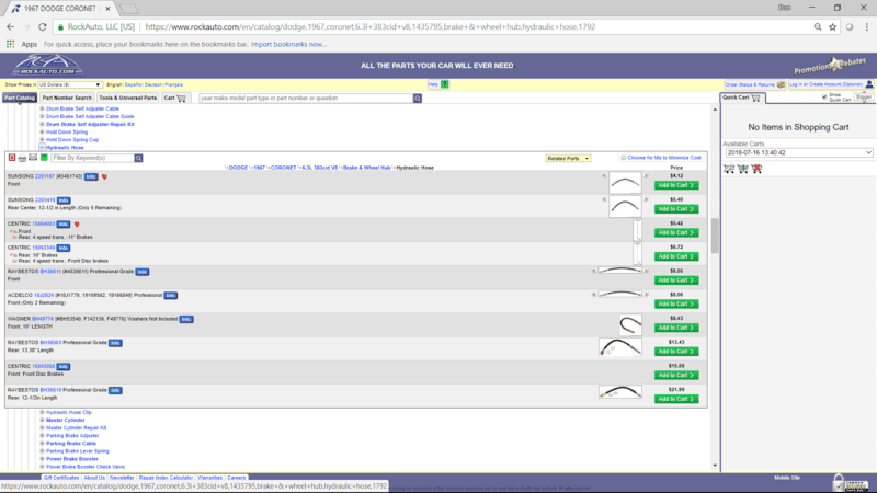

2 each front lines and 1 rear hose.

Carefully follow the directions for bench bleeding the master cylinder (it's pretty easy).
Then install the works, bleed the system.
