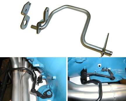

TTI makes a "torque shaft" that has a woop-t-doo in it to step over the header collector, if it interferes with the 727 shift linkage. I had to install one of these on the last b body column shift I put headers on.
"A modified design Torque Shaft Assembly is required if your drivers-side stock straight torque shaft rod is mounted below the torsion bar. The stock straight torque shaft rod passes directly through the space where the header tubes or the exhaust pipe must go."

Wow, that sucks. Mine is on a column shift 1970, I'm not sure if the 66-67 had a different location for the torque shaft. The hookers clear it easily though on the '70.

Don't think you're gonna need that torque shaft. According to the TTI site is shows applications for '71-74 B-bodys and '65-73 C-bodys. But what do I know...

That's cool. I made one around 1978 with a piece of re-bar, the original linkage, and a stick welder. Worked great.
