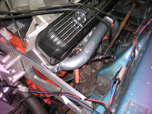

I'm using the 2" Doug's D452 in my '62 Dodge with no issues. No hammer required. The TTIs are very similar if not the same routing. I haven't heard anyone complain yet about either one in the early B bodies. It all depends on how much you want to spend. The thing you have to consider is if you have a B block or RB block. Doug's and TTI specify this.

I have the Doug's D452 headers on my Savoy and they fit very well. I had to trim the lip off of the race bell housing for #6 tube and removed the grease fitting off the pitman arm as it was making contact on the drivers side lower tubes when turning.

I'm running Doug's on my 383 65 Coronet. Had to ding the right side for clearance, What I like about Doug's is that they don't hang down from other headers that I have found.
