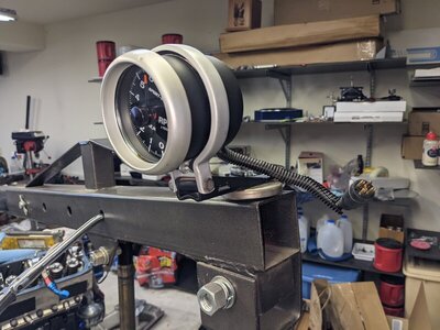

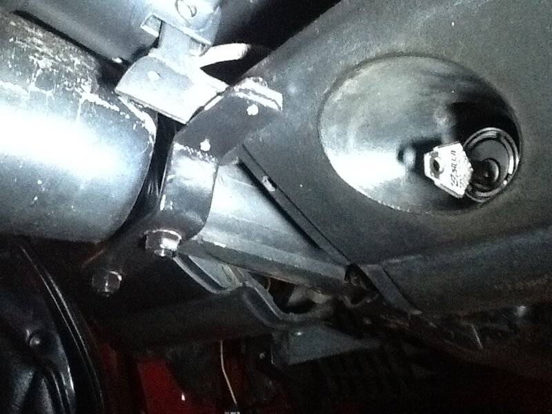

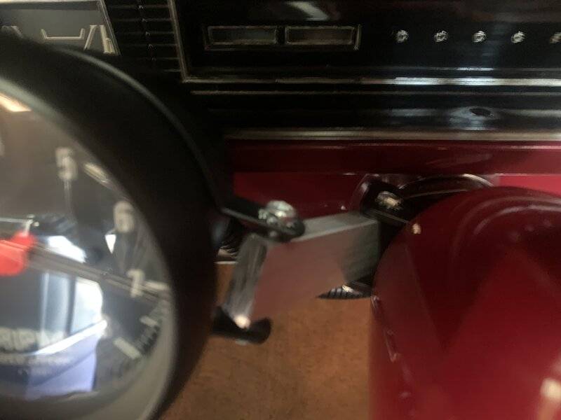

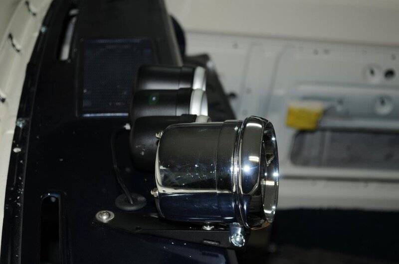

Hey mate, Terry from NZ, just had the same problem so found a 2 1/4 exhaust clamp and bent up some 3 1/16 x 1" flat and mounted to clamp. Looks and works great, will try to attach pics, hope this helps. Cheers.
I like the industrial look to it. I have column shift so I may have to have it extend higher. Thank you for the idea and the pics. I will post up what the final looks like.

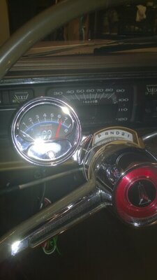

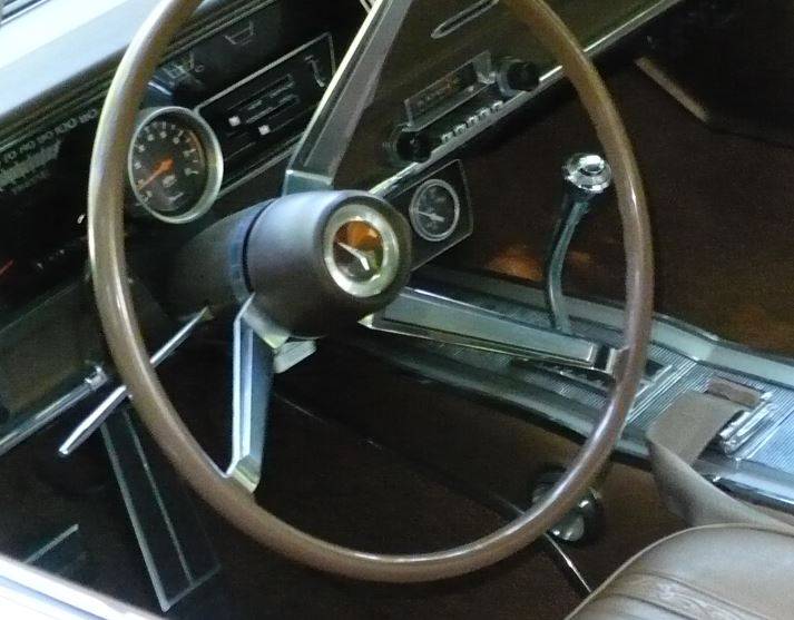

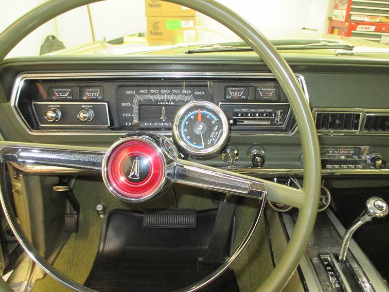

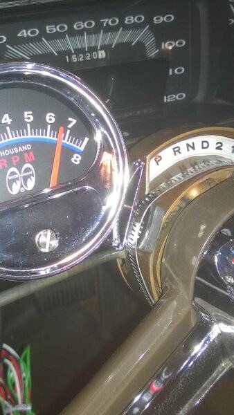

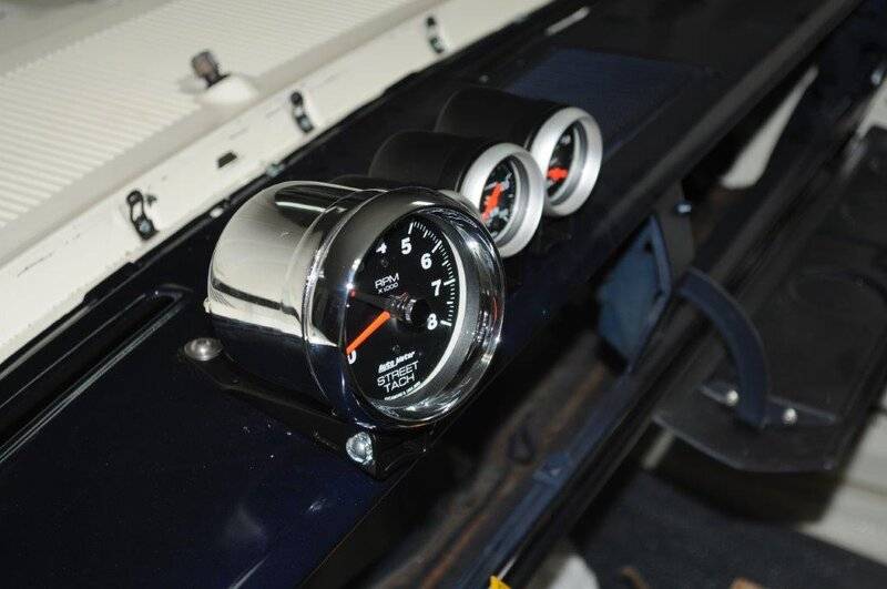

here's my 66 Satellite with the mounting pieces right from the box. I used a large hose clamp after I slid it in rubber.
I did something similar to post 4 but I put in a small wood spacer painted black.
I also turned the mount around, so the tach is closer to the wheel, and away from the dash.
I had to do that to make it work on my 73.
Thank you for the ideas and pics. The biggest problem I am having is column shifter interference. I think making a similar bracket and extending it higher may work.

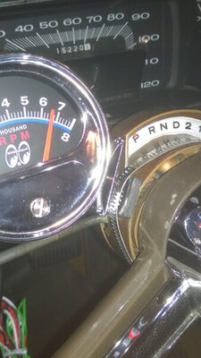

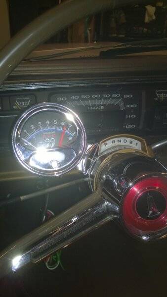

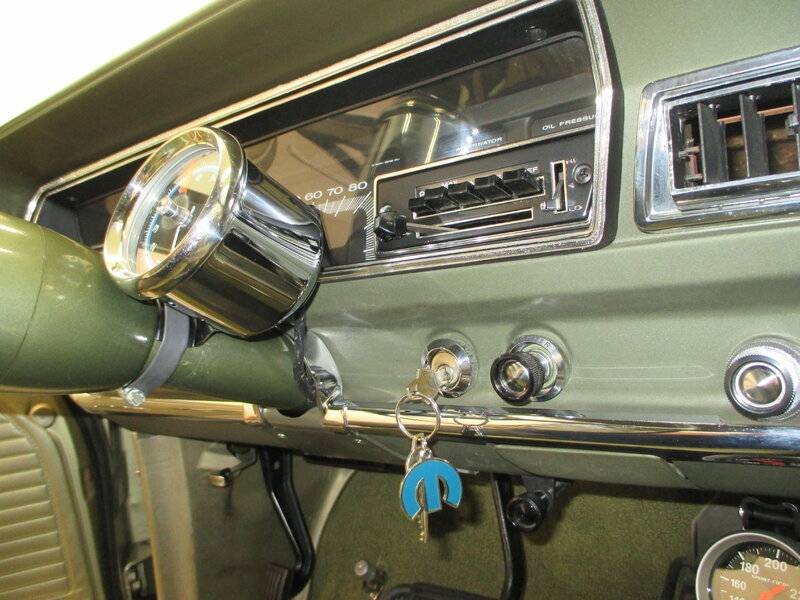

This was my solution when my '67 still had the 727 column shift. I modified the supplied mounting bracket that was too short and had a bad angle. A little wrinkle paint and it looks like it grew there. 30 plus years of dust gives it that barn look.
And before anyone says it, the speedometer is from a '72.
Try adding a spacer block.

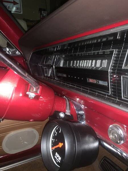

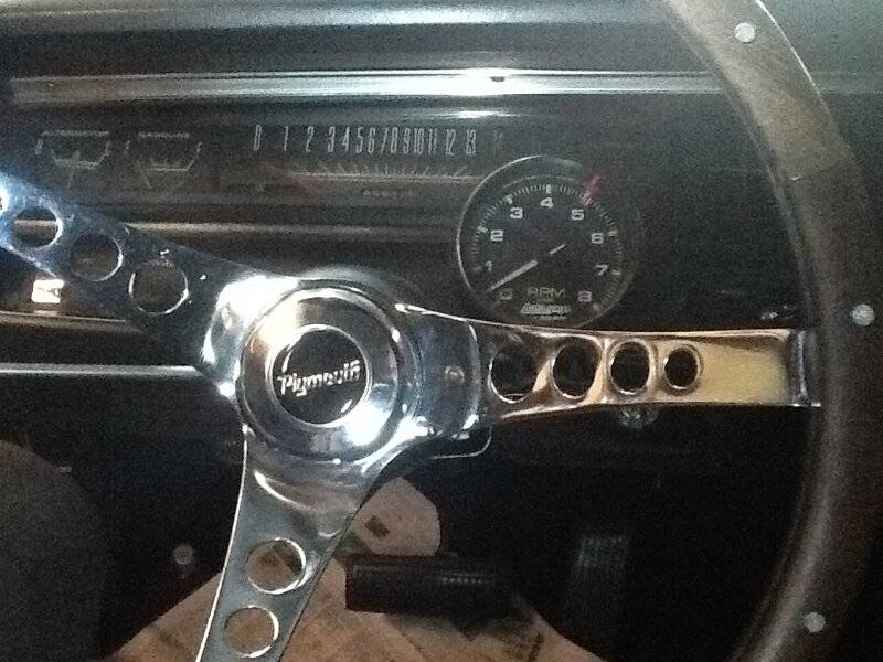

Here is the mount I made for mine. It just sticks to the dash and can be moved to exactly where you want it.
Cut a hole the diameter of column in a piece of wood. Cut it in half so I had a U made strap to go around column. Painted wood black.
Mount ed tach first .

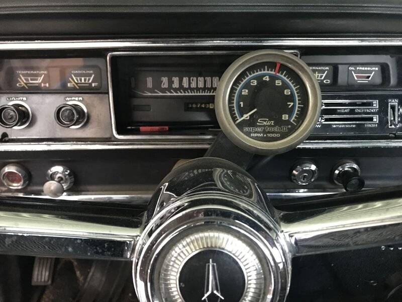

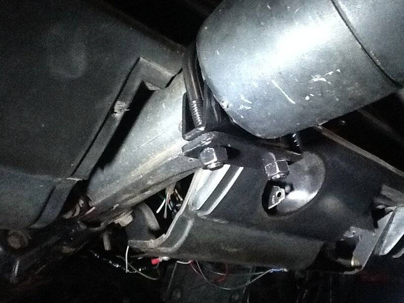

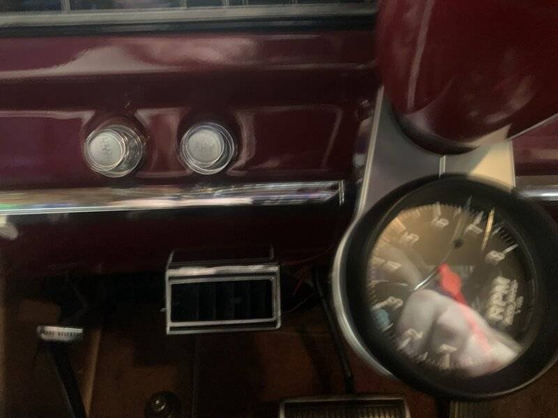

Here are a couple pictures of mine. I'm working with a column shift as well, so needed to make a little foot for the mount that came with the tach. Let me know if you want any other angles, or a better picture.

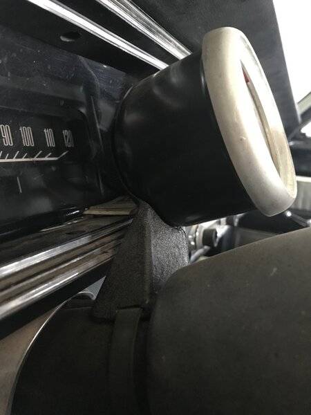

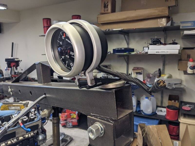

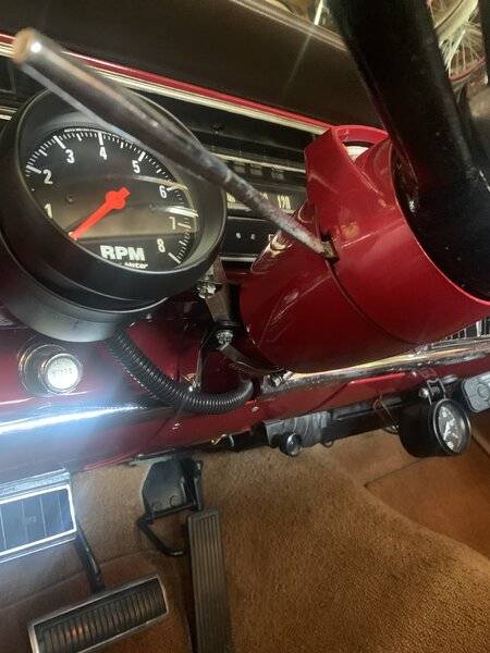

A couple tries at making a new bracket. 1st one, terrible idea, bought a pre made aluminum bracket. I couldn’t position it at the top and kept rotating down.
What I ended up doing was using some aluminum bar stock and the auto meter brackets. I will get it coated this winter. Too much to do now. Thank you for the ideas.
