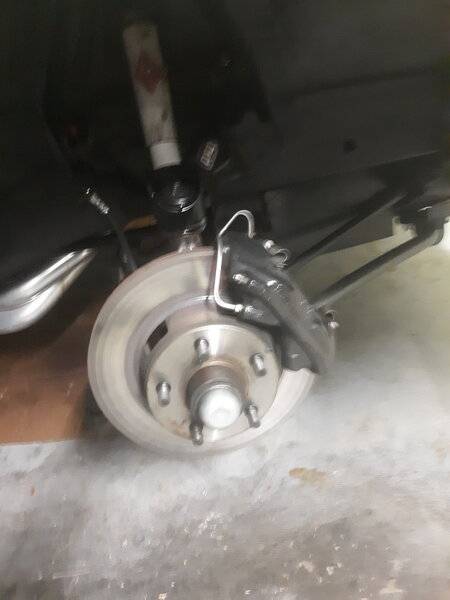

thanks for the sympathy my friend I wanted to include a picture of my disc set up after seeing yours this I believe is the way the caliper is supposed to be installed I've tried doing some extra bleeding techniques in case there was an air bubble trapped in there

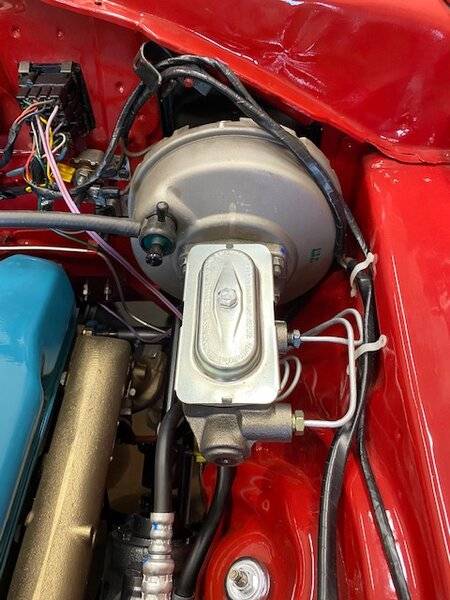

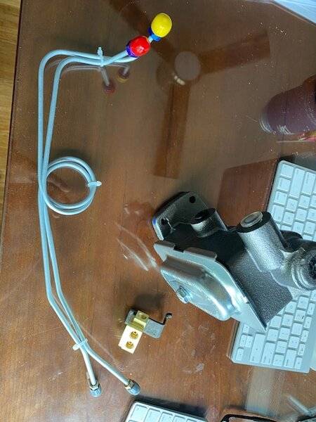

Don and the rest of the great Coaches here, Thank you for your kind support. We got the new booster in finally and got the brakes bled yesterday. Fingers crossed. Something that happened and might happen to others is the following.
The dual res MC that most big box stores sell for this application is a 1 inch bore. It however does not have the MOPAR 9/16s by 20 as the front hole. Instead they come as 9/16s by 18. The rear hole is as per MOPAR specs. The folks that provide the wonderful bent brake lines send the Correct 20 end for the fronts, so I had to cut that off and put on a 9/16s by 18 to make it work. Got to test my Double Flare skills as well. :) Anyway, here is Before and After. Best to you all, B.
