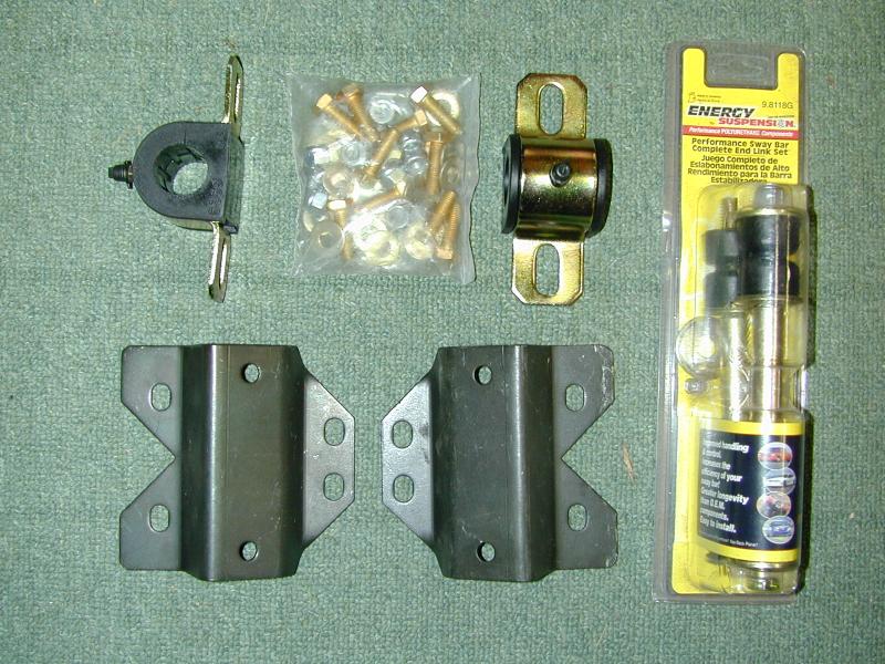

I'd be grateful for some advice, I have a 66 Coronet with no Sway bar fitted. Among some spares that came with the car, was a mounting kit as pictured;
The bushings are for a 15/16" diameter bar, but is this for a standard or aftermarket fit ? Can anyone recognise the bits and advise which bar I need to buy? I remember seeing a couple of posts before that make me think there are a few different types out there....
This is aftermarket stuff. If you want I can dig up some pictures of the stock setup for '66. I have a complete setup in the shop.
