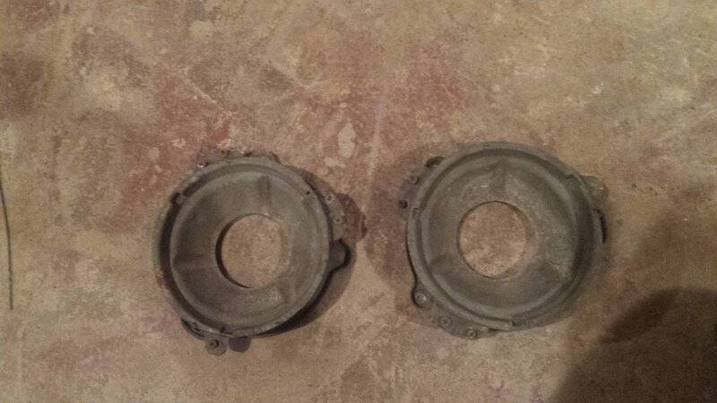

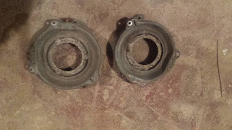

I have these.

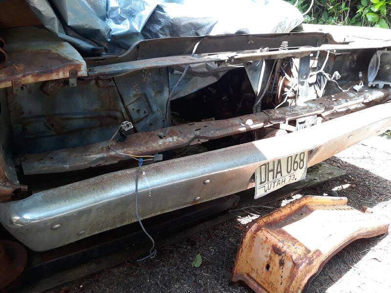

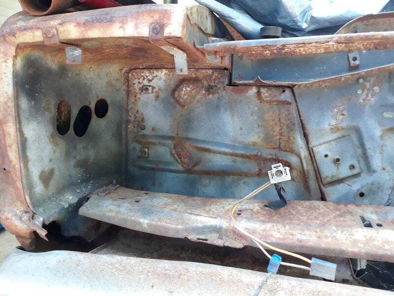

I finally got back to tack a pic of what I have left of where the mounts were. Can barely tell where welded on.
