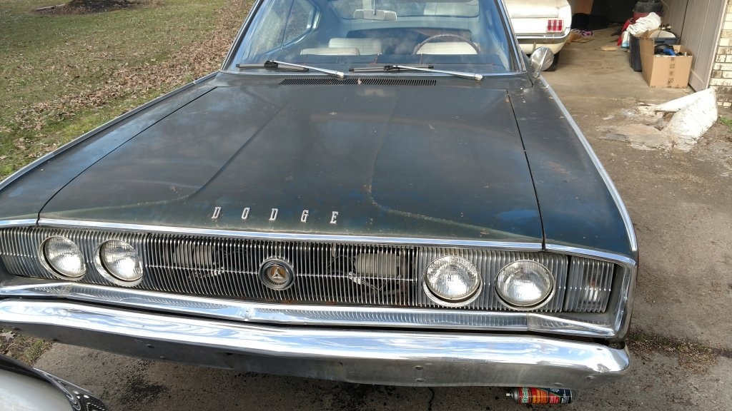

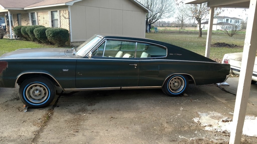

Hey everyone. I'm a veteran spent 10 years in the air force and then moved back to Arkansas.
My car is a 1966 Charger. it was a survivor with original paint. one family owned it before me, MATCHING NUMBERS :) 80,000 miles. 383 auto with factory power brakes and a/c. it has been in the shop for the past 3 years. but I'm supposed to be getting it back this weekend(cant count how many times I've heard that). So anyways everything is new on the engine except the block bored out .060 and mildly stroked. new e-street edelbrock heads, performer rpm intake, electronic ignition engine is setting at 416 ci ready to go in. aprox 550 hp 600ft. lbs. torque. transmission has been rebuilt as well
I CAN'T WAIT
the to do list
1. limited slip differential
2. upgrade brakes to disk(has a new master cylinder and drums are working) and that probably means new wheels and tires. with that $$$$
3. interior already have a site for carpet seats are a different story
4. body is very strait but has a dented up fender right around the shaping at the front.
5. upgrading the suspension
If any one knows of a disk brake kit the will fit under factory 14s or a good limited slip diff that is streetable please let me know.

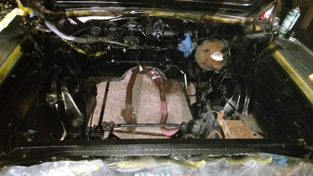

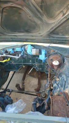

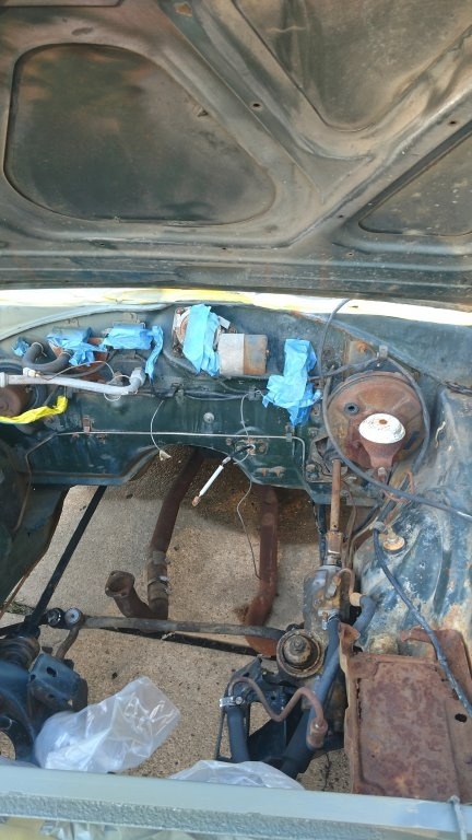

looks like im getting it back with engine and tranny in but not wired up. just my luck
