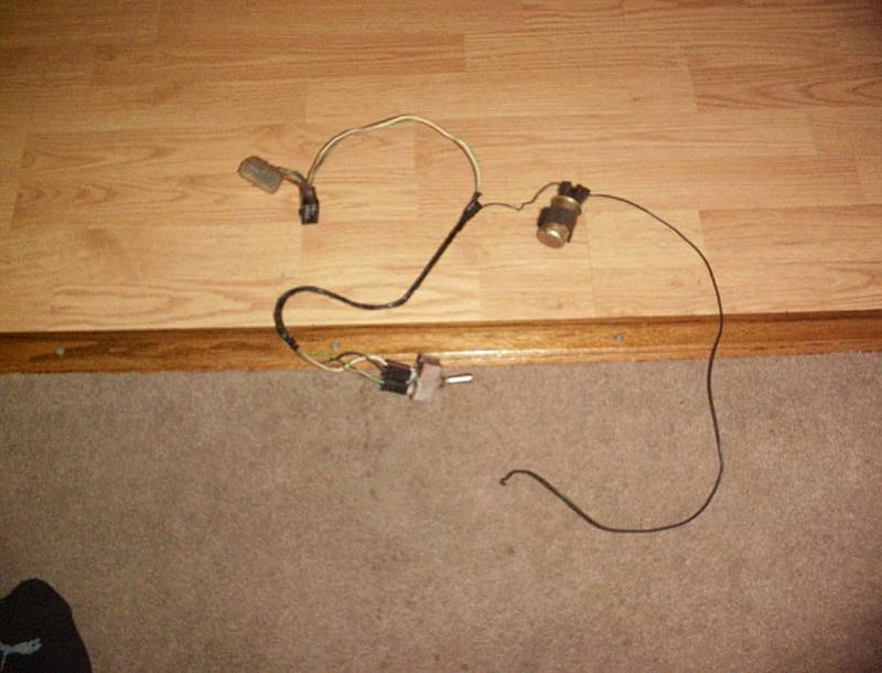

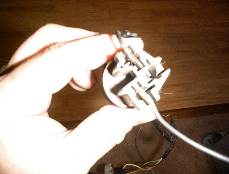

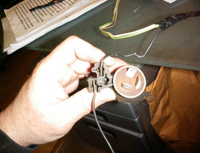

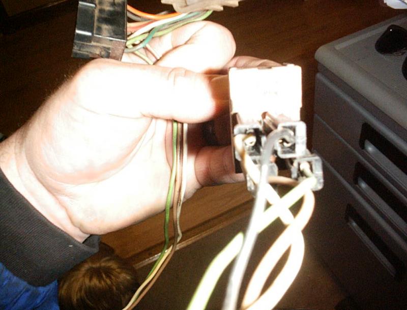

I am working on getting my emergency flashers to work i have removed my flasher wiring and it seems that i,m missing a wire i have 2 black going to flasher canister 3 connectors on flash canister and a wire missing what color should the other wire be and where does it go. The black wire where does it go i have pic could someone please help me thanks. FD820392.jpgFD820393.jpgFD820394.jpgFD820395.jpg
The black wire should feed the turn signal flasher from the fuse box. There is thread on this somewhere. I will see if I can find it.
Here is the link to the thread:
http://www.forbbodiesonly.com/moparforum/showthread.php?46944-1966-Dodge-Coronet-Charger-with-factory-four-way-emergency-flasher&highlight=emergency
