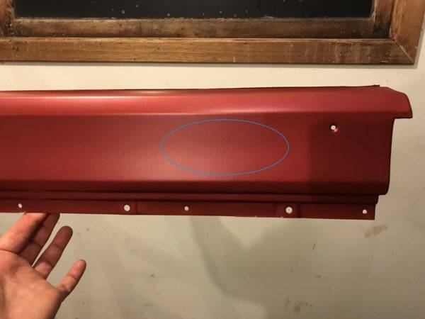

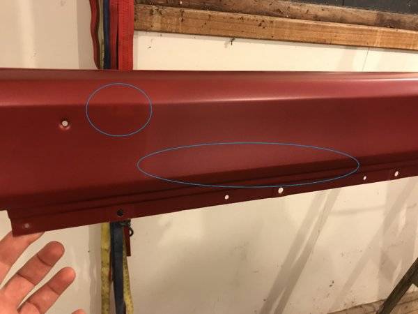

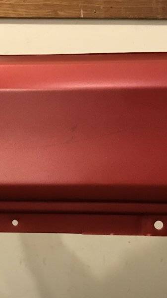

I am in the process of doing some touch-up work on some interior pieces. I ordered a can of Herbs Interior Paint. I am very impressed with the color accuracy; not so much with the coverage. The rear trim panels in the pictures has 6 coats. I assume that since the paint is designed to penetrate into plastic/vinyl/carpet, it will not cover base color abnormalities or scratches.
The main thing I will be painting/color-matching closer to spring is a door shell that is now black; want to paint it red to match the rest of the interior. Again, since this paint is so transparent, I doubt that it will cover the black paint to match.
Has anyone used a metal primer, prior to applying Herbs Interior Paint? Considering a "red metal primer" in this case.
I used Herbs paints on interior soft trim and it worked well. I would not use it on metal, not saying you can't but I don't think it's designed to be used on the doors or metal parts like you have there. You would use base/clear or single stage auto paint on those parts.
